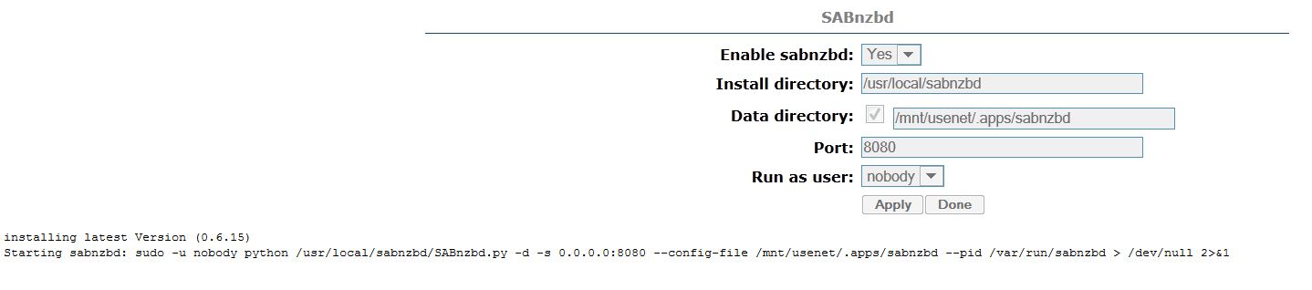

I have still been unable to figure out my problem with setting up SABnzbd.  I have followed the tutorials online, but it appears as if it is not installing correctly.  Can someone help? I can give information, but I do not know what information is needed (or how to get it, really).
One of the symptoms that I think is wrong.. is when I click on sabnzbd in the unraid settings and click on apply, it seems to get stuck on this screen (screen capture below).  It says in the status bar something about "transferring data from tower".. and it just continually shows the connecting sign on the tab.  The only way I've found to get out of this is to do a hard shutdown (as all the buttons in the lime tech window are greyed out including main, shares, etc).
Also when I do this, the prompt from the unraid machine says OSError: [Errno 13] Permission denied: '/mnt/usenet'.
Are you using the Mount Any Drive Plugin or Snap Plugin? If not, then you should change the data directory from /mnt/usenet/.apps/sabnzbd or install Benni-chan's Mount Any Drive Plugin.
Benni-chan's examples are using his Mount Any Drive Plugin for the data directory location: http://lime-technology.com/forum/index.php?topic=14742.msg138819#msg138819
You may want to read this entire thread from the beginning (even if you already did, it may help you catch something you missed).

xml parse error
That doesn't work at all. Get errors during install.
on line 13
