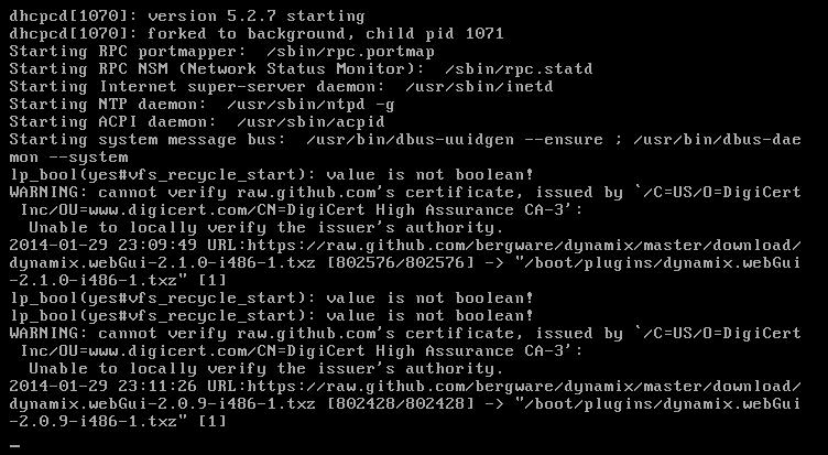

On another note, I grabbed a screen shot of some errors I saw on boot. It appears vfs_recycle_start is having an issue. Something about a value not being a boolean.
EDIT:
Disabling vfs_recycle and re-enabling it seems to have fixed that issue on boot.
