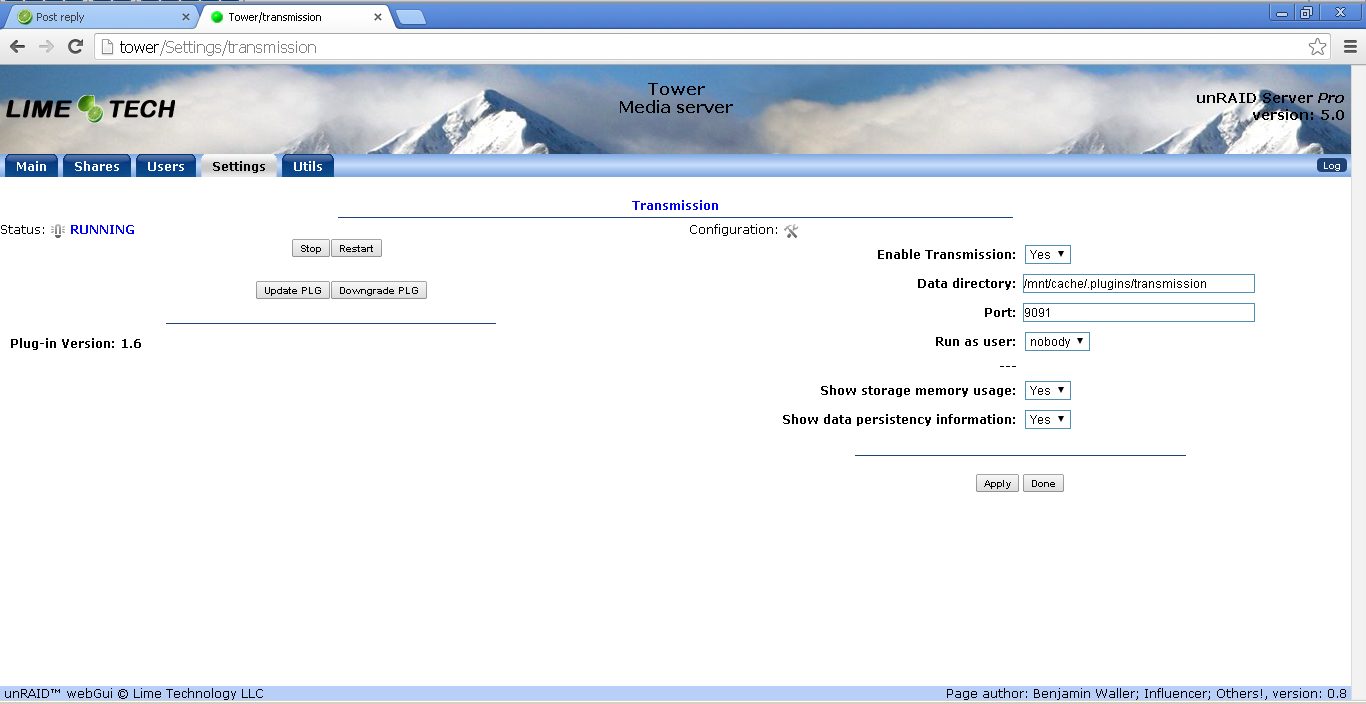

Please help. Transmission keep dying on me and I don't know why or how to find out. Is there any logs? The settings page says the status is RUNNING, but it is not. When I start it it runs fine for a few days then when I check back it has crashed.
Where do you have it installed?
Post screenshot of settings page.
Sorry for late reply.
I got the plugin from here: https://raw.github.com/Influencer/UNplugged/master/transmission_unplugged.plg
I have it installed here: /mnt/cache/.plugins/transmission
Please see attached settings.json and setting page screenshot.
I have 1.5GB ram, I don't know if that is a problem.
Thanks.
