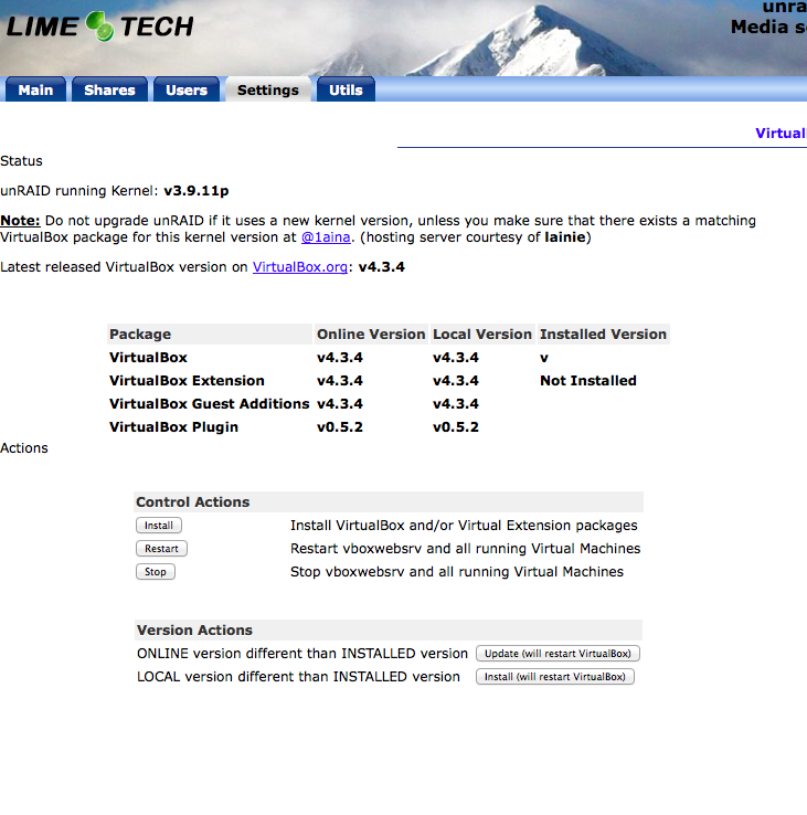

Hello,
I updated to unraid 5.04 and I have some strange issues with virtualbox, all other plugins are working fine.
Since no kernel upgrade I thought VB 4.3.4 should works fine with 5.04.
I deleted packages and re-download again with same behavior. It install it but then on plugin I got only a letter V instead a full version name but in syslog I got:
Dec  8 11:25:35 unraid rc.virtualbox[13154]: Latest VirtualBox (v4.3.4)/(k3.9.11p) does not exist in local plugin folder, removing all existing local versions and downloading...
Dec  8 11:30:22 unraid rc.virtualbox[15723]: Latest VirtualBox Extension (v4.3.4) does not exist in local plugin folder, removing all existing local versions and downloading...
Dec  8 11:30:31 unraid rc.virtualbox[15756]: Virtualbox not installed - nothing to stop
Dec  8 11:30:31 unraid rc.virtualbox[15757]: vboxwebsrv not running - nothing to stop
Dec  8 11:30:36 unraid rc.virtualbox[15788]: Installing Virtualbox package (v4.3.4)...
Dec  8 11:30:42 unraid rc.virtualbox[16026]: Symbolically linked /mnt/cache/Apps/virtualbox/vbox-files to /root/.VirtualBox
Dec  8 11:30:42 unraid rc.virtualbox[16027]: Installing Virtualbox Extension package (v4.3.4)...
Dec  8 11:30:42 unraid rc.virtualbox[16055]: VirtualBox and/or VirtualBox Extension not installed - cannot start vboxwebsrv
Dec  8 11:30:42 unraid rc.virtualbox[16082]: VirtualBox and/or VirtualBox Extension not installed - cannot start Virtual Machines
Dec  8 11:30:42 unraid rc.virtualbox[16083]: Updated VirtualBox to version 4.3.4
Dec  8 11:31:50 unraid rc.virtualbox[16213]: Latest VirtualBox (v4.3.4)/(k3.9.11p) and VirtualBox Extension (v4.3.4) exist in local plugin folder
Dec  8 11:31:50 unraid rc.virtualbox[16241]: No Virtual Machines running - nothing to save
Dec  8 11:31:50 unraid rc.virtualbox[16242]: vboxwebsrv not running - nothing to stop
Dec  8 11:31:55 unraid rc.virtualbox[16289]: Installing Virtualbox package (v4.3.4)...
Dec  8 11:31:55 unraid rc.virtualbox[16370]: Symbolically linked /mnt/cache/Apps/virtualbox/vbox-files to /root/.VirtualBox
Dec  8 11:31:55 unraid rc.virtualbox[16371]: Installing Virtualbox Extension package (v4.3.4)...
Dec  8 11:31:55 unraid rc.virtualbox[16399]: VirtualBox and/or VirtualBox Extension not installed - cannot start vboxwebsrv
Dec  8 11:31:55 unraid rc.virtualbox[16426]: VirtualBox and/or VirtualBox Extension not installed - cannot start Virtual Machines
Dec  8 11:31:55 unraid rc.virtualbox[16427]: Updated VirtualBox to version 4.3.4
Dec  8 11:32:28 unraid rc.virtualbox[16885]: Latest VirtualBox (v4.3.4)/(k3.9.11p) and VirtualBox Extension (v4.3.4) exist in local plugin folder
Dec  8 11:32:28 unraid rc.virtualbox[16913]: No Virtual Machines running - nothing to save
Dec  8 11:32:28 unraid rc.virtualbox[16914]: vboxwebsrv not running - nothing to stop
Dec  8 11:32:33 unraid rc.virtualbox[17012]: Installing Virtualbox package (v4.3.4)...
Dec  8 11:32:33 unraid rc.virtualbox[17093]: Symbolically linked /mnt/cache/Apps/virtualbox/vbox-files to /root/.VirtualBox
Dec  8 11:32:33 unraid rc.virtualbox[17094]: Installing Virtualbox Extension package (v4.3.4)...
Dec  8 11:32:33 unraid rc.virtualbox[17122]: VirtualBox and/or VirtualBox Extension not installed - cannot start vboxwebsrv
Dec  8 11:32:33 unraid rc.virtualbox[17149]: VirtualBox and/or VirtualBox Extension not installed - cannot start Virtual Machines
Dec  8 11:32:33 unraid rc.virtualbox[17150]: Updated VirtualBox to version 4.3.4
any ideas?

Hello,

Same here when virtualbox goes to install it starts to then screen refreshes with only a v for version instead on v3.4.3 - also noted that in the install directory of the 3.4.3 package there might be a doinst.sh file that is not there, that was in previous tgz packages.
I did a own compiling , and the vbox is running OK
More info here --> http://lime-technology.com/forum/index.php?topic=25099.msg274366#msg274366
//Peter

Looks like the same problem I am having and there are several others on the other VirtualBox thread. The recent virtualization discussions has stimulated my interest in this again as a learning exercise. I used to have this working several months ago, but removed it. Now I am having this problem getting it going again.
I am on unRAID 5.0.4 and using the bonienl's recent release of the Dynamix webGUI and webserver to run phpvirtualbox on, but I think my problem is with getting vboxwebsrv running so phpvirtualbox will have something to connect to. My symptoms are exactly the same as yours.
As said before on this same topic lainie's 4.3.4 package for 3.9.11p is broken, it will not work, and lainie seems too busy to fix it at this moment.
I did "compiled" vbox 4.3.4 myself on unRaid 5.0.3, I think it should also be ok for 5.0.4 since same kernel and minor config changes on it apparently... if you want to try it:
http://nars.aloj.net/temp/unraid/vbox-4.3.4-unRAID-3.9.11p.tgz
Else you can use these simplified steps/scripts to "compile" it yourself:
