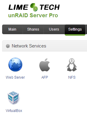

in this case..take a screen shot of the web server setting in web gui so i know exact setting you have.

Open Web Browser and go to 192.168.0.43/settings
        Select Webserver icon and ensure
              Web Root Directory = /mnt/cache/appdata/www
              Listening Port = 8804
