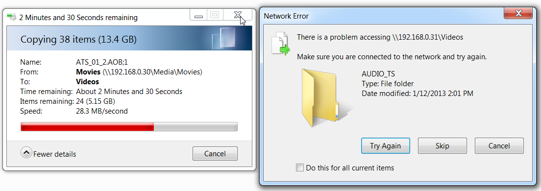

I'm having a problem when writing files to a share.  The error messages include:  Network Error  There is a problem accessing \\server\share  Make sure you are connected to the network and try again.  It appears the network connection fails to the 5.0-rc10 server in the middle of a file transfer, however if I try again the file transfer again it will complete.  Also, clicking "Try Again" doesn't allow the file write operation to complete/continue, but if I click "Cancel" and try the same file again it works.  I've also noticed that this issue keeps randomly occurring.
This issue was also present in 5.0-rc8a after the "sysctl vm.highmem_is_dirtyable=1" command workaround was found for the slow write speed, I just didn't have time to post.  I'm still using the "sysctl vm.highmem_is_dirtyable=1" command in my go script to maintain a decent write speed to the array.
I've attached a screenshot of the error messages received as well as the syslog.
Edit:  I'm wondering if this problem is related:  http://lime-technology.com/forum/index.php?topic=24281.0
syslog-2013-01-12.txt
