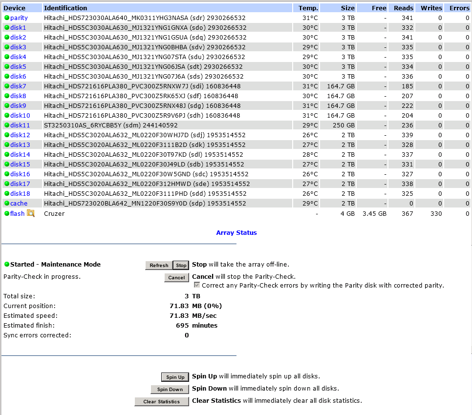

Had an unclean shutdown, upon reboot, I selected to start the array in Maintenance Mode.
Web GUI states Array started in Maintenance Mode AND started a Parity sync in Maintenance Mode.
This should NOT be the case right? Screenshot attached.
