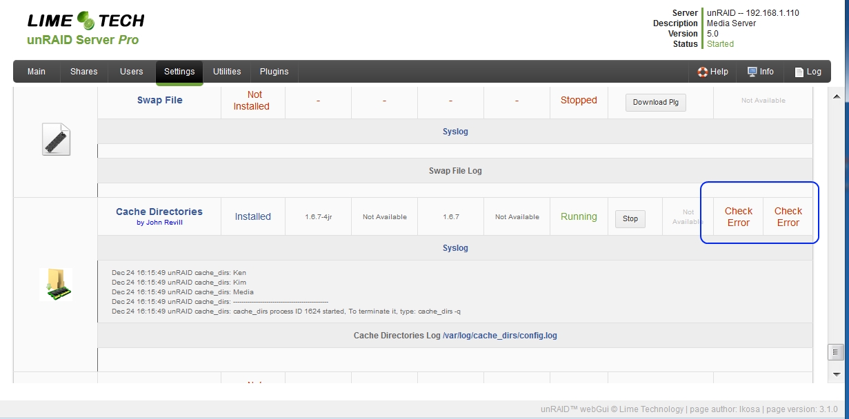

I have this plugin installed and used it to install the Cache plugin. But, I keep seeing "check error" for the Cache Plugin, beside it. Any idea what would cause this? I just upgraded to 5.0 from 4.7.
Why some package says Unavailable?
Check error means control panel cant get either local or remote version number, mostly because that plugin don't have that feature. Or for some reason either version number is empty.
Unavailable means that plugin don't have that feature.

I've installed Transmission from Control Panel and now it's running, I have 2 "check errors" showing,  1 under "update plg' and 1 under "update app", is this something to be concerned about?
