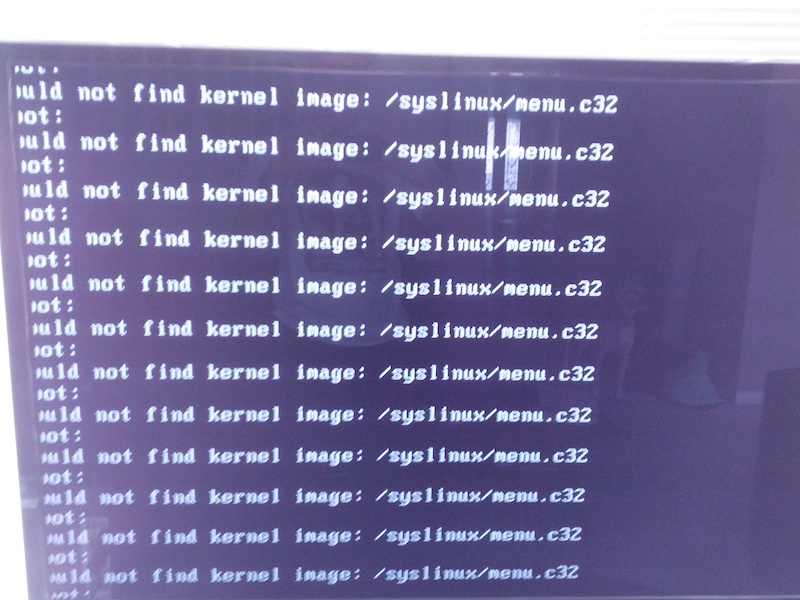

I'm upgrading from 5.0rc12a to 5.0.5.  I am running into a problem where my Unraid server is unresponsive over WebGui and Telnet.  I've looked on my router and I don't see an IP address assigned to it but I'm not sure how to tackle the problem.  I've changed ethernet cables and made sure they are seated properly.  On my first boot I saw activity on flash, cache and disk drives (my parity is not hooked up via a HDD cage) but I could not access my webgui or telnet after 15 mins or so.  I rebooted a few times and then started looking at my server's IP address.  After that I need some help?
Upgrade process I followed
Stopped all plugins (Sab, SIckB, Transmission, ITunesServer)
Made sure parity was good and configuration valid.
Backed up flash drive and then followed instructions here http://lime-technology.com/wiki/index.php/Upgrade_Instructions
I did not run the make_bootable.bat file as I was unsure if I needed it.  I'm thinking my flash drive is not bootable so that is why nothing is up and running.  Is that a good guess?  Can I just plug my flash into my PC and double-click the make_bootable.bat file and retry?
Thanks.
Post a syslog.  You will probably have to  hook up an monitor to the server and see if the server completes the boot process before you can do this.  You should get a login prompt when/if it does.  If unRAID boots,  you can get a syslog by following the instructions for 'console session' in the first post in this thread:
    http://lime-technology.com/forum/index.php?topic=9880.0
If it fails to boot and you can't figure out the problem, post a photo of the monitor screen.

Seems my upgrade is to blame.  I lugged the server over to the TV and looked at the bootup sequence.  I keep getting a loop on the screen of
Could not find kernel image: /syslinux/menu.c32
root: (or boot:)  The screen is not displayed properly
I remember when I followed the upgrade instructions noticing I did not have a syslinux directory on my flash drive but the 5.0.5 image had a directory.  Question is can I just copy this over to my flash drive>  What about the syslinux.cfg file? It is in my root directory so should I delete that one as in 5.0.5 it exists in the syslinux directory.

Yes, you should be able to just copy the syslinux folder from the install directory to your USB drive, and you can delete the syslinux.cfg file in the root. You will want the new one anyways as it gives you the option for a safe boot. You can also copy everything from the root of the install folder to your USB. It will not overwrite any of your config files. Just be careful not to copy the config folder over as that will reset your disks, shares, networking and users.
So, to summarize:
Install media has:
/ (root folder)
/syslinux
/config
Highlight everything and deselect config and copy to your USB stick. Then I'd re-run make_bootable to be safe, and you should hopefully be good.
So, to summarize:
Install media has:
/ (root folder)
/syslinux
/config
Thanks for the info bkastner.  Just a quick question.  When you say rerun make_bootable should this be at the cmd prompt or will double click in Windows Explorer work just as well?
Assuming you are running Windows 7/8 just right click and run as Administrator. It will open the cmd prompt and run the script.

I also found a syslinux.exe and menu.c32 in my root drive (the 5.0.5 image has it in syslinux).  I'm assuming it is safe to delete these 2 files as well?

You may have already done this, but yes. You can just use the format from the image file. Those are the only files you need in the root directory.
