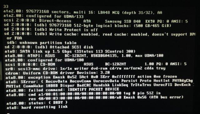

A couple of observations.
  • I had a bluray drive plugged into my test box and 6.0b4 wouldn't load in plain or Xen.
  • I have only added a cache drive to my array of the test box so far to have a play with VM's but cannot start the array as no other disks added.
I was checking the upgrade instructions in the changelog but it appears to only have directions from beta 1/2 and I'm running beta 3. Is there any difference or should I just follow the beta 1/2 directions? Also I've had a lot of freezes on beta 3 and I wanted to know if there was any way to have the log stored in a file for 24 hours (i know it'll get quite large), but it appears to be crashing overnight and when I get up in the morning it's frozen (can't telnet/putty into the server).
Care to elaborate?  Maybe a syslog?
I'll plug the Bluray DVD drive back in to try to get some more detail but it stalled while loading, same place for both standard and Xen.
If I go to Extensions - Xen domains it states "array must be started to view domains" but in Main - I have no option to start the array because only a cache drive is added.
Image added of screen shot.
