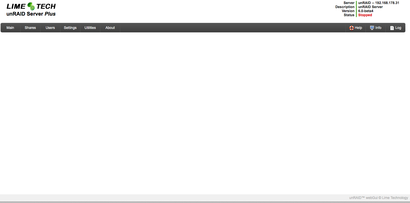

i updated to the latest beta and now the web interface does not response.
The syslog and screenshot are attached. I also tried another browser and clearing the browser cache...
syslog.txt
I had that. Delete the downloaded GUI from the plugin folder.
That worked! Great, thanks.
