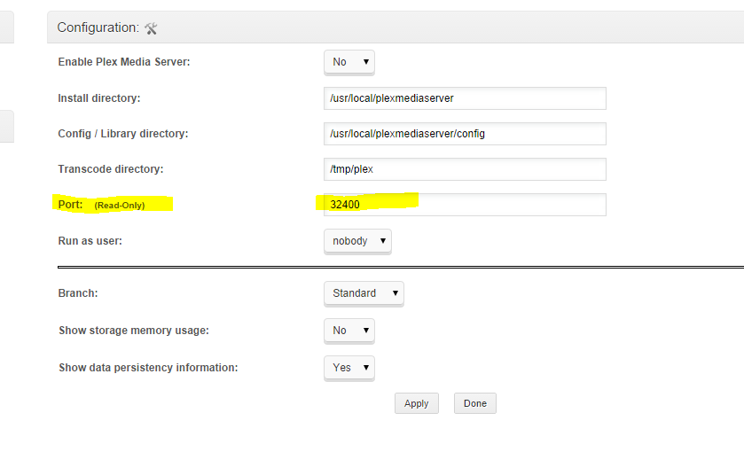

Hi Phaze - A couple of questions..........
I am running unraid 6.0 beta 6 and i installed your plugin and now on the config screen i noticed the port is read only, I am already running a plex server on my WIN 7 machine and have it ported already for 32400, is there a way to change the port in the plugin?
My router cannot have two ports be forwarded on 32400 on 2 different computers.  - Would this approach work? - https://forums.plex.tv/index.php/topic/106899-plex-pass-2-servers-but-only-1-shows-up/
Also don't i want my config/Library directory pointing to my Cache drive?
Your thoughts
AJ
Your thoughts
AJ
Yes, you want your config/library pointed to your cache drive, you need to change that on the config page.  Otherwise your library will be erased after a reboot. What you have currently set is just the default location.
As for the port, according to https://forums.plex.tv/index.php/topic/39502-changing-plex-internal-port/ you can't change the internal port on Plex, and need to change the external port.  Your router is capable of this.  It would look like this:
External IP port 32400 -> internal PC1 IP1 port 32400
External IP port 32401 -> internal PC2 IP2 port 32400
You only have one external IP so they need to use different ports, as for your two servers, they each have their own different IP internally so they can use the same port.  I think you can log into each PC's plex server (if you actually have two plex server installs) and in the config you can map the port to a random port number for the external port. It will automatically map to different ports.
