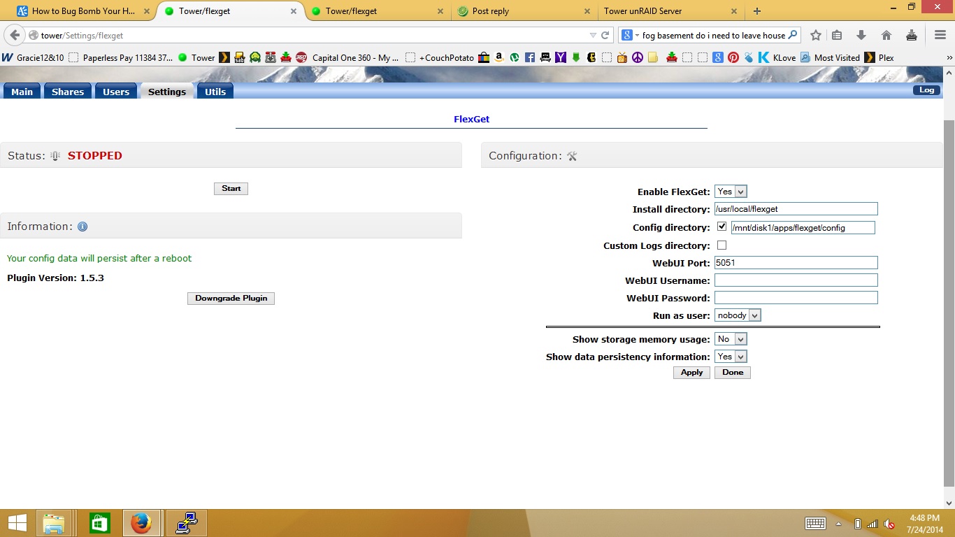

Great work Phaze, I am however having an issue getting plexget to start.  It installs fine, but just won't start.
on what version on unraid?
sorry didn't include enough info; unriad 5.0.5, also had tried it on 6, but downgraded for other problems.  Although I never could get it started on 6 either.
