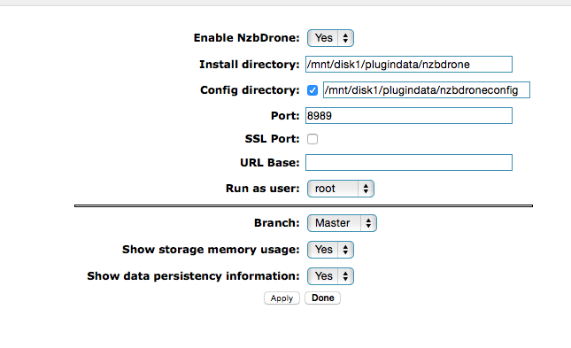

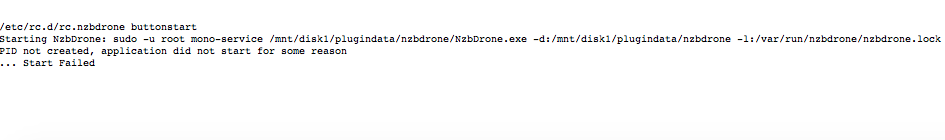

Hey Phaze.
I am getting the same issue but with NZBDrone:
PID not created, application did not start for some reason
... Start Failed
I also note that it won't update either, it offers to update the program but after a page refresh the option to update remains.

Can you try seeing run as to nobody and press apply. See if that helps first. Did you have it working previously?

Hey Phaze.
... Start Failed
That didn't work and its a first time setup on this specific box.
