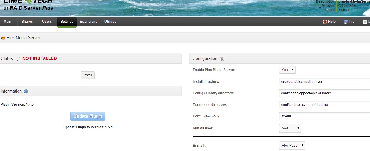

You mean config or the temp and library etc? That's on my cache drive. And the plug is in boot/config/plugins But it won't work on reboot.
Here is a screenshot of mine:
As you can see, the install directory is /usr/local, but the other two folders are using /mnt/user/cacheonly folders. It also clearly states that my settings will survive a reboot. I'd suggest you compare yours to mine and make sure you see the two messages on the left (config will survive reboot and transcode is on a physical drive).
I installed the Plex plg but after every reboot the Plugin settings page says Plex not installed. How do I get it to automatically install and run on reboot?
That should automatically happen as long as you have "enabled" set to yes. After a reboot, it will try to start, discover its not installed and runs the install function, then continue to start it.
The only way this won't happen would be if your plugin folder has read only access and the enable setting can't be saved.
Here is my screen shot.
I don't have a clue as to what is wrong, but may I suggest pushing the big blue button to update the plugin and see if that changes the symptoms? It would appear you are MANY versions behind.

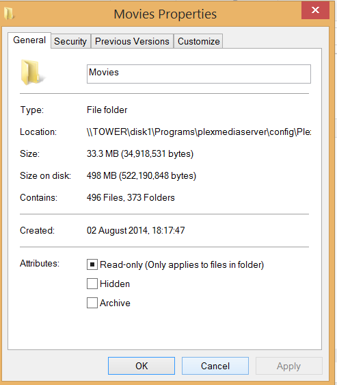

Also, I noticed that when looking at disk usage for the metadata folders, the difference between "Size" and "Size on disk" is huge (see attachment).  I'm guessing this is something to do with disk sectors or something?!?  Still a huge difference...

Size is based on 1000 bits per KB, size on disk is more accurate and is based on 1024 bits per KB. That's normal for all OSes. Usually though when it's that big of a difference it is because of disk sectors. Since the metadata is thousands of small files, they don't always full the sector completely which leaves some wasted space. Expand that up to GB with of data and you actually waste a lot of space on disk. But your pic shows a massive difference. Maybe music metadata is the worst for this.
