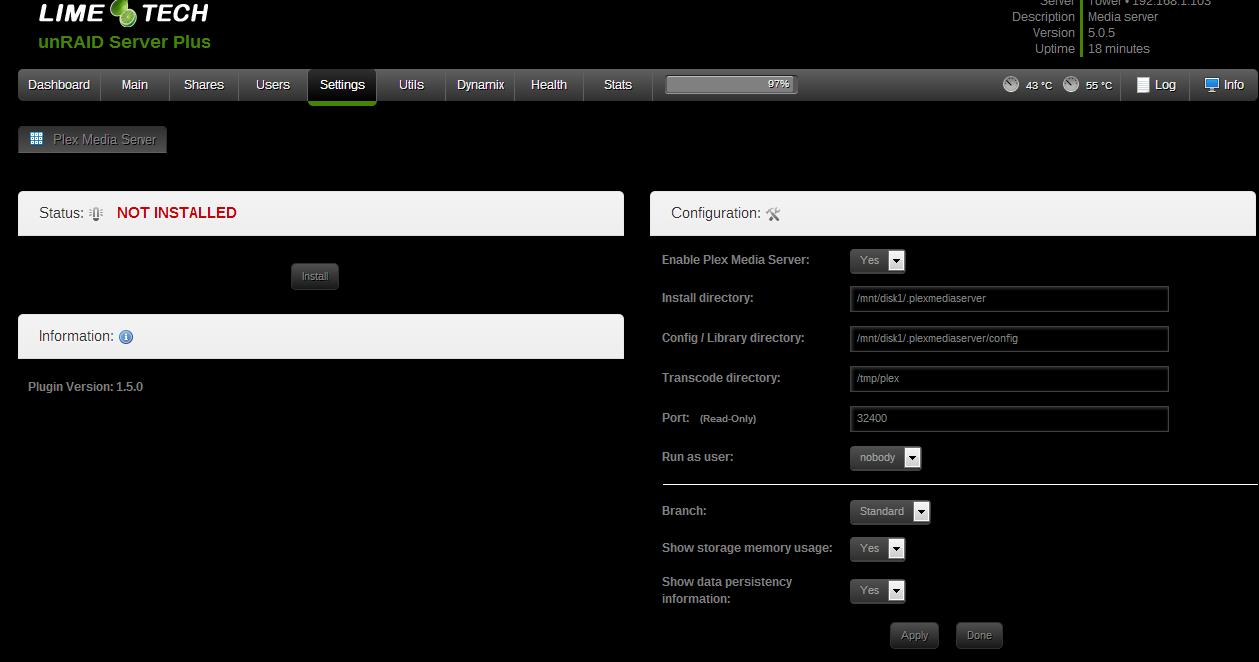

Hello PhAzE,
Just wondering, why after pressing install, it says OK, but nothing is installed?
I'm installing it at /mnt/disk1/.plexmediaserver, and /mnt/disk1/.plexmediaserver_config
This is definitely the GCC package that's installed and blocking AR from extracting the app. Check the help link on the first post for help with that.
Hello PhAzE,
You are right that the GCC has some errors.  It says the some files no longer present in the URL.  Finally got GCC installed.  Now, I still have the same issue, I clicked on install, and still says not installed.  Where do I begin to troubleshoot?

Hello PhAzE,

You need GCC to be uninstalled. You also need to uninstall glibc. Go to /boot/packages and delete glibc....txz and the GCC one also. Don't use those and reboot then Plex will work.

If you go to your prompt any type "ar --help"  (I think) does or come up with the options for ar?
Oh and in/boot/packages is the Plex download file there? If so, delete it. Let the plugin download or again. Its quite large and their servers are slow.  I would say they have a 30% chance of a corrupted download happening for some reason. I've been asking on the Plex forums for the md5 hashes to be posted but they apparently haven't/won't do it so there is no way for my plugin to verify the download is good.

Hello PhAzE,
Deleting plex from packages and allowing it to re-download worked!  Thanks for all the help.
