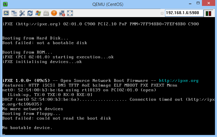

I converted a CentOS IMG to qcow and used the example XML you provided and modified only to apply to my local paths and CPU.
I get the following error on launch:
root@NAS:/mnt/vm/CentOS# virsh create centos.xml
error: Failed to create domain from centos.xml
error: internal error: unexpected domain type kvm, expecting xen
XML file:
	<domain type='kvm'>
  <name>CentOS</name>
  <uuid>0ea490aa-5de5-4d04-a383-50a1ec6f1639</uuid><!-- uuidgen -->
  <memory unit='GB'>8</memory>
  <currentMemory unit='GB'>8</currentMemory>
  <vcpu>8</vcpu>
  <os>
    <type arch='x86_64' machine='q35'>hvm</type>
    <loader>/usr/share/qemu/bios-256k.bin</loader>
    <boot dev='cdrom'/>
  </os>
  <features>
    <acpi/>
  </features>
  <on_crash>destroy</on_crash>
  <devices>
<!-- VIRTUAL DISK (IMG)-->
You're booted into Xen mode. Boot into 'standard' unRAID as KVM is built into the Linux kernel but can't work alongside Xen concurrently.

Ok, first and foremost, I have an archVM (based on Badger's v4) that I have had successfully running with Plex specifically now on two different hosts (an unRAID AVS 10/4 Server and a custom-built tower with consumer-grade desktop/PC components).
I'm looking for the networking issues you guys have reported, but I don't experience any.  As of now, these VMs are running under Xen mode using the webGUI to start/stop them (not using virsh/libvirt or domain XML yet).  My Xen CFG file is as simple as this:
