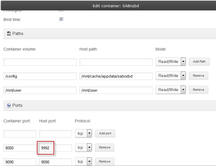

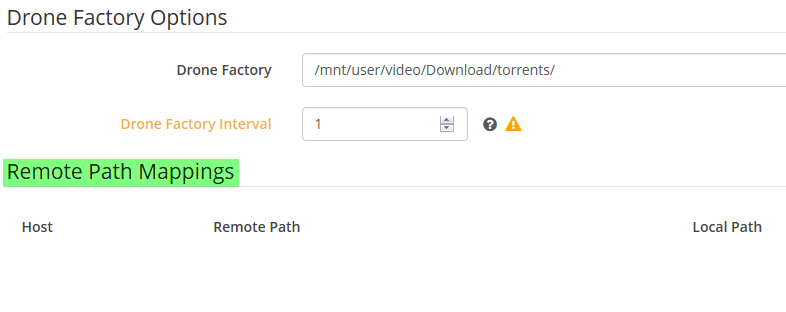

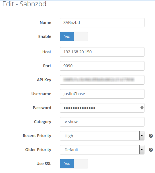

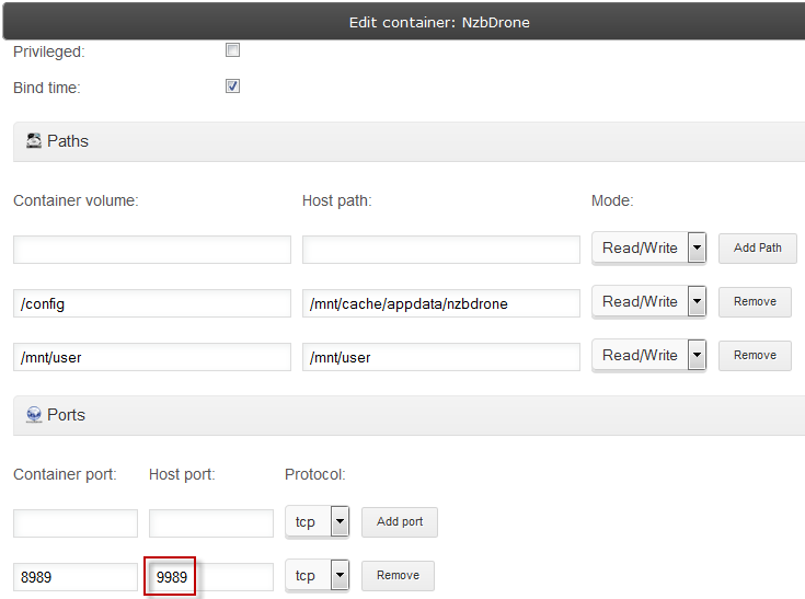

Please post a screenshot of the settings page where you're entering the information, then testing, and the error, if possible.
**added my settings page for comparison

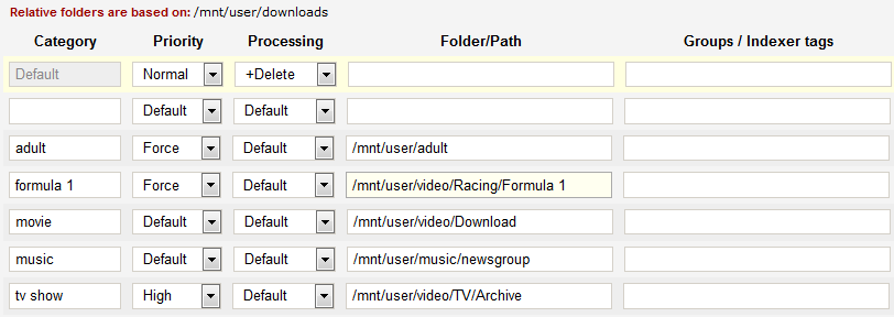

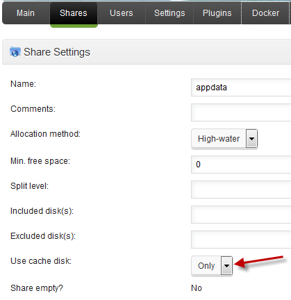

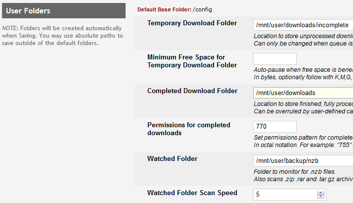

nothing jumps right out at me from your screenshots, but they are cut off, and unclear what exactly they are of in some cases.  In particular, the error message is cut off.  it appears to be a problem with the path it's finding someplace, but I'm not sure where exactly it's coming from.  perhaps the missing bit will help with that.
However, in the meantime, attached are my screenshots for comparison.
Of note: if you are using unMENU, or other plugins or dockers, it's very possible something else is using port 8080, and that could be tripping you up.  you'll notice I've changed my settings to use other ports, to ensure no conflicts.  Perhaps you can try the same, just to confirm this is not the problem.  To do this, you can just change the settings in the docker setup dialogs and save.  it will amend your ports without reinstalling or anything else, it's very fast/easy to change these.
If you still have trouble, please post your screenshots that match the ones I've posted, and make sure that they are full/complete, and no messages are obscuring the information, so that we can see everything you're using.

also, do you have any manually entered remote path mappings?  It's the only place I can see that might be using "path", which seems to be causing your error.
Thanks Justin. For the screenshots that have parts missing I did not change the defaults, which were all blank.
I removed UnMENU earlier to see if that helped but made no difference.
I am going to set mine up like yours and see does it help. It looks like you have everything covered with the pics though.

SUCCESS!!!  :)
I followed your screenshots exactly and I have successfully send nzbs to sabnzdb, have had them download, renamed and moved to the appropriate folder. Its working perfectly.
Thank you so much for your time Justin. You gave a perfect tutorial.Its much appreciated.
I'm sure I'll bump into some other issues down the line when setting up other dockers but for now all is well.
Can I suggest that your screenshots be either moved to a new thread or to the op in this one.
They were spot on and in 10min I had accomplished what I could not do over a few hours.
