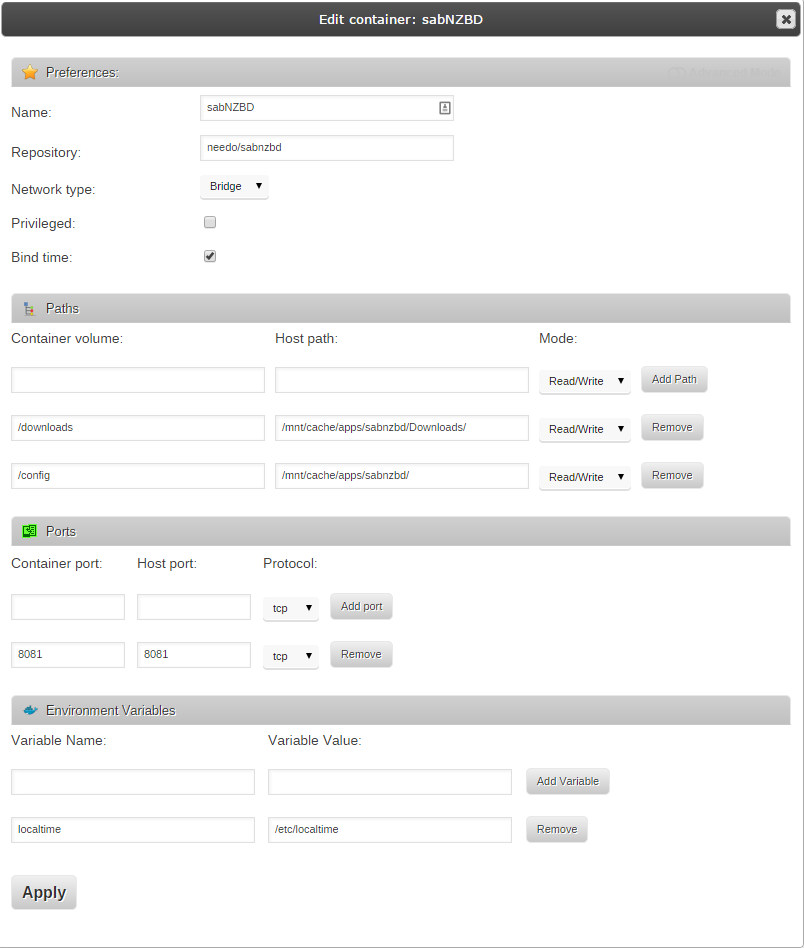

Im new to Docker and thought i had everything figured out with it but apparently not.
I just installed the SABnzbd app from needo's repo and when i start it i am unable to access the web gui for it. I have attached a screenshot of what everything looks like in the docker configuration screen. I am using the docker tab on the unraid menu to start my containers, etc.
When i try to access the web interface for sab or any of the others i have tried (couchpotato, nzbdrone) i just get a web page cannot be displayed error
Hopefully its a dumb mistake on my part that you guys can point out so i can keep moving with this.
