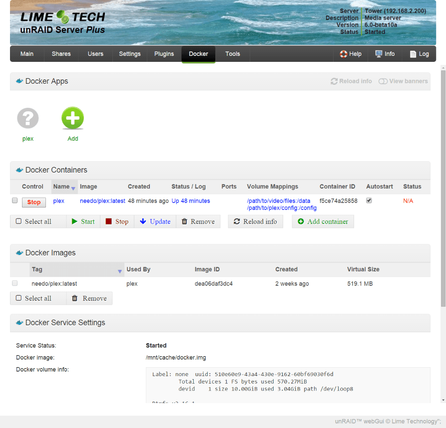

I installed plex using docker run -d --net="host" --name="plex" -v /path/to/plex/config:/config -v /path/to/video/files:/data -v /etc/localtime:/etc/localtime:ro needo/plex as described. When trying to log in using
http://192.168.2.200:32400/web/index.html#!/dashboard  (using my unraid server ip number) or http://tower:32400/web/index.html#!/dashboard or even http://server:32400/web/index.html#!/dashboard I get "This web page is not available" - I can not connect to plex.  :'( Still it is supposed to be running. I tried adding a user "plex" to unraid and unistalling and installing - but no change. What am I missing? I have no previous installation of plex - it has never been running on this server. I do have a plex pass and unraid plus (but no experience running plex and only a week with unraid, which is working well though.
Being new to both unraid and plex I'm guessing I'm missing something rather basic here?? Any help much appreciated!  :)
your path settings in the docker command are wrong.
you have to change /path/to/plex/config and /path/to/video/files to something existing...
for example this:
docker run -d --net="host" --name="plex" -v /mnt/disk1/appdata/plex:/config -v /mnt/user/Media:/data -v /etc/localtime:/etc/localtime:ro needo/plex
(make sure, you change these folders accordingly to how you named your shares)
it's easier to add new docker containers with the web interface
Thank you so much, Benni-chan! Worked like a charm! :) Happy happy happy!

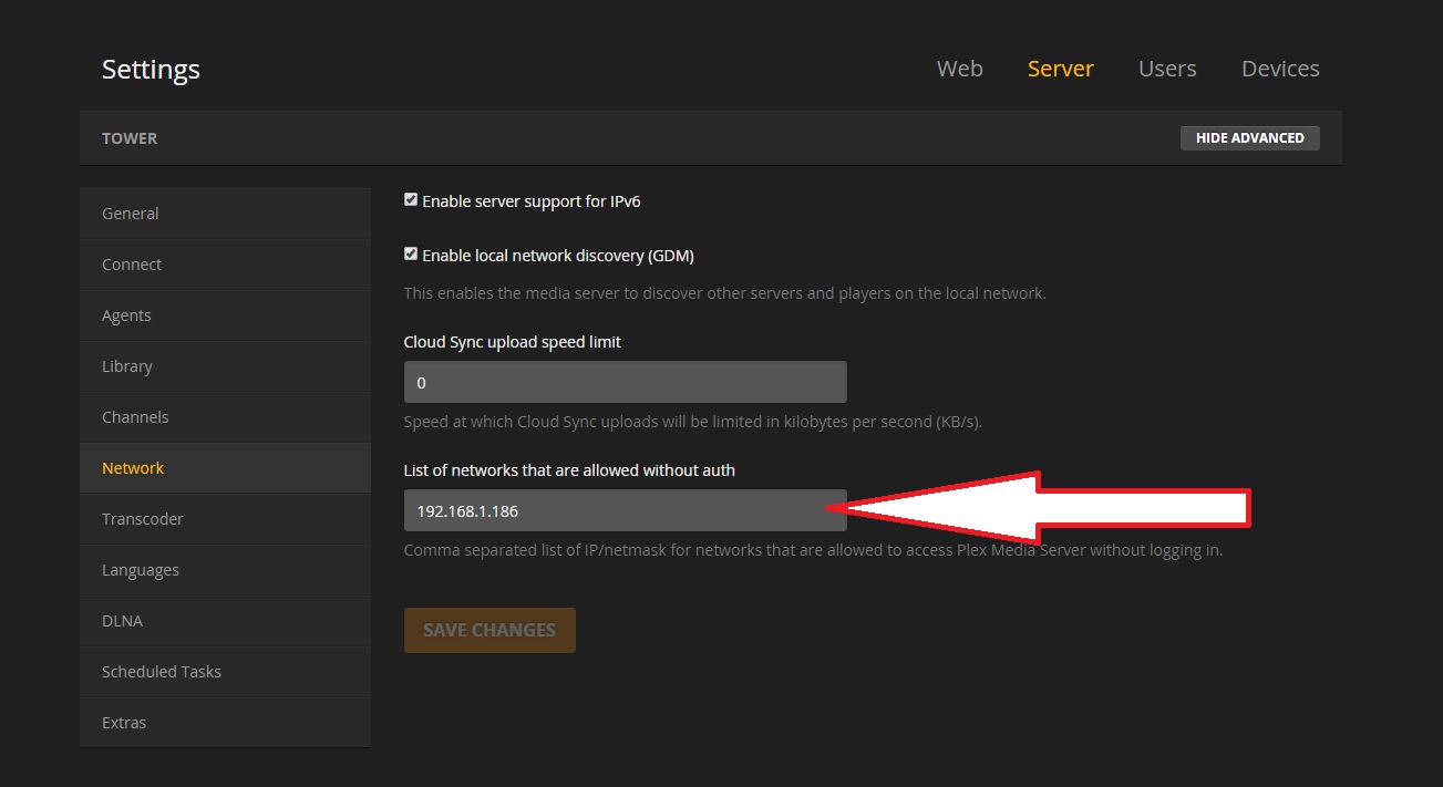

Found the fix more me..
Needo's plexwatch does run for me but didn't connect to plex after I installed Needo's latest update for plex.
This is how I fixed it..
In Plex got to seetings/server/network/
and add the IP of the unraid server to the  "List of networks that are allowered without auth"
I attached a picture as well.
Hope this works for you guys.
Unfortunately that does not work.  The only thing that seems to work is disabling the new Plex Home feature in the server which means losing this new function.
