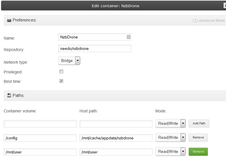

For some reason NZBDrone refuses to download anything automatically (if i run an episode scan on a season), I have to download via the manual route.  Also it does not move files at all, they are all sitting in my download folder.
I'm pretty sure I have it configured properly (copied my previous config, and changed folders etc).
Any ideas?
I am trying to configure NZBDrone to play with SABnzbd but when I test the settings I get -
"Test was aborted due to an error: Unexpected character encountered while parsing value: <. Path '', line 0, position 0."
Any ideas?
Here is my SAB settings -
I'm sure I messed a path up. Any help is appreciated
yeah, your paths are messed up.
You've set /downloads (what you'd put in SAB) to connect to /mnt/user/Media
Meaning if you want to point SAB to /mnt/user/Media/something, you'd enter /downloads/something as the path in SAB
the /downloads is the same as putting /mnt/user/Media in the path box.
So, for movies you'd enter /downloads/Movies and for TV, you'd enter /downloads/TV
Next, you're entering /cache/apps/... in path boxes for your download locations, but SAB doesn't know what cache/apps is, since you didn't map it in the config file when setting it up.
Now, what I do to avoid all this is put /mnt/user/ and /mnt/user in the SAB config file.
So, under container volume, where you put /downloads, you should change it /mnt/user, then under Host path, where you put /mnt/user/Media, you should change that to /mnt/user also.
This makes it so that when you enter paths in SAB, they look/act the same as in unraid directly, so /mnt/user/Media/whateveryouwant  will work the same in all places.
Finally, by doing the above, you'll still need to fix the path in downloads that has /cache/apps, since /cache isn't in the mapping above.  You could either add one more container > host mapping, and enter /mnt/cache/  to  /mnt/cache/
or you could do what i do, and just make sure the share you want to point to (/cache/apps/whatever) is a share, but set it to be 'cache only', which will force it to stay on the cache drive, but will also show as a regular share, which you could access at /mnt/user/apps/whatever.
I know it may sound confusing, but do you best, and ask if you get stuck.
With regard to above post, i am not able to add existing tv series to nzbdrone, im not sure if my problem is the same as above or maybe slightly different, your damn right its confusing  :o
when i set sab up i imported my settings.ini from the previous v5 plugin install, not sure if that is causing my problem, i just setup the nzbdrone docker as per instructions..my tv share is /mnt/user/tv but it says path does not exist..i tried what you said above but then all my folders in sab i have setup dissapear. can you see where i am going wrong ?
in the nzbdrone config
change /downloads to /mnt/user
change /mnt/user/downloads to /mnt/user
save changes
do the same in sab config.
it should look similar to my screenshot

Where exactly are you getting this error?  When you try to 'install' the docker, when you run it, after install, etc?
I've not heard of, nor seen that error, so I'm not sure what it might mean, but it's not obviously related to incorrect path information, so it might just be something else
One thing to double-check is that all your path info/folder names are all capitalized correctly.  Linux is case-sensitive, so if you have a folder called nzbdrone, but you put NzbDrone in the config, it won't like that.
From looking at your screenshots, it all looks good to me, so I'm guessing something else is going on here.  If you can't make progress from here, you might move the folders from /appdata/thesefolders  to someplace else, so you have them as a backup, but can start "fresh" with a new install.
If you go this route, then I suggest, remove the docker/container, completely, and start from scratch, and let it re-download and install again.
I know it can be frustrating, believe me, but I do think you're close to having it working.
Finally, do make sure that any folders related to docker that you have on your cache are in a share marked as "cache only", otherwise the mover script will move it to the array, and nothing will work tomorrow :)
