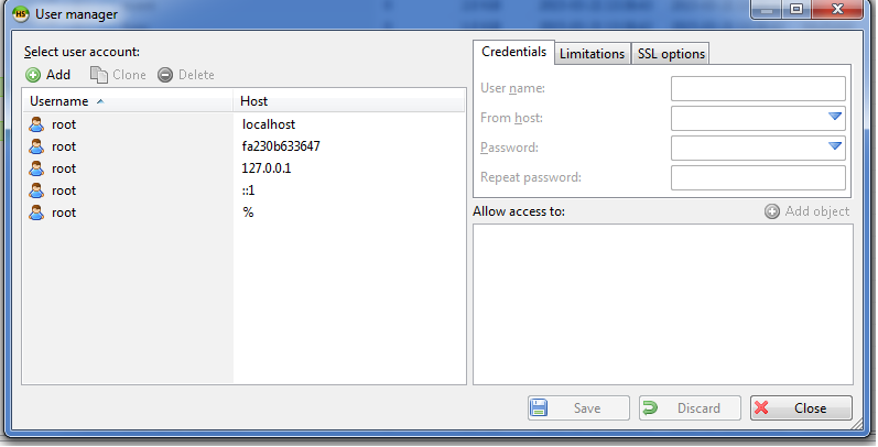

1. Simply login to MariaDB with HeidiSQL using the unRAID's IP address with root as username with no password.
2. In HeidiSQL click on Tools then choose User Manager. Find Root and change password.
3. While in HeidiSQL might as well create the ownCloud database and ownCloud user: ex: ocowner
3.A. on the left pane right click your mouse, choose Create new -> Database , and name it what you like ex: owncloud and click OK.
3.B. Click on Tools -> User Manager -> Click Add at the upper left corner -> enter User name, then choose From host (its your preference but I suggest your local LAN), enter password twice,
3.C. then at Allow access to: you may Add object (your preference but I would choose your database to start with and select the entire Database ). I did not choose Global privileges as I believe this will be like adding MariaDB root privileges to ownCloud root user, and this is not desired or necessary IMHO. YMMV.
3.D. Click Save. Exit HiediSQL if you wish.

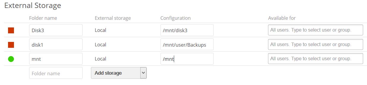

I'm trying to get my unRaid files recognized, however owncloud "red lines" my typing /mnt/disk1 or /mnt/user/usershare.  See this:
