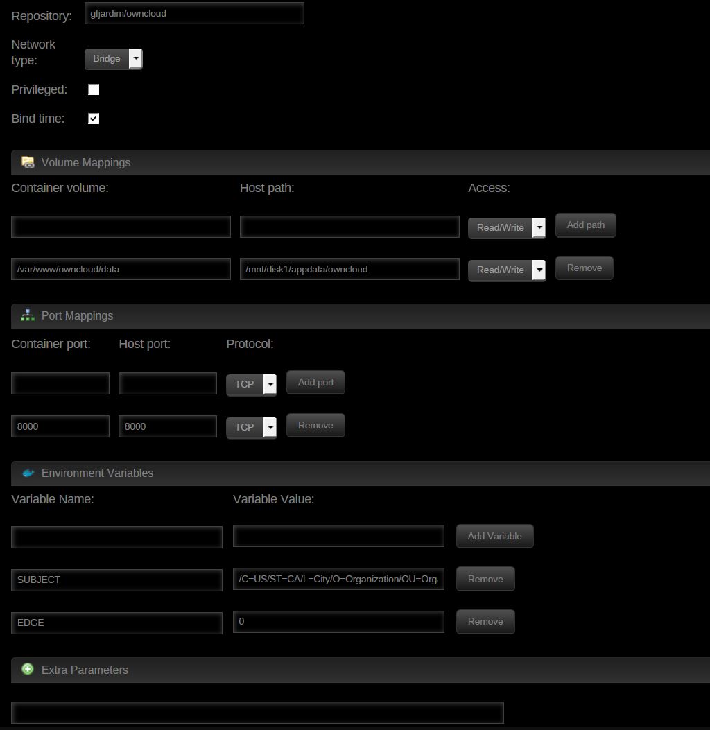

I'm trying to get my unRaid files recognized, however owncloud "red lines" my typing /mnt/disk1 or /mnt/user/usershare.  See this:
Unless you set up the paths when creating the Owncloud docker, those paths will not exist.
why are you disk labeled in different case  disk1 and Disk3
I am just playing around.  I understood that the folder name is just a text description, so it doesn't matter.
On the docker setup page??  Here is what mine looks like.
So right now your owncloud docker only sees /mnt/disk1/appdata/owncloud folder and it thinks its called /var/www/owncloud/data.

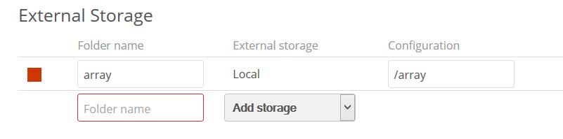

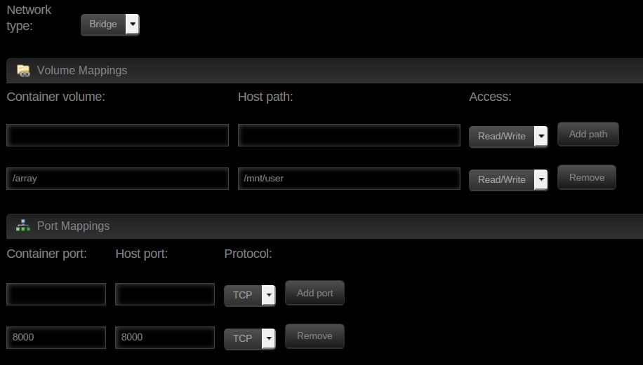

If you want to pass the whole array path.  Container path would be /array and host path /mnt/user.
Then in owncloud you would put /array in the paths and it would see all of your array data.
I feel dense.  Like this??
I'm still being given the red no go signs....

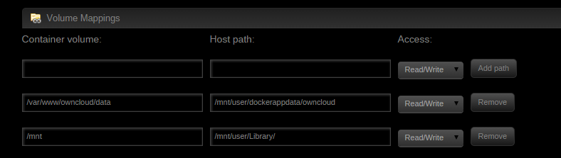

heres mine so you can check - only difference is the / at the end of /mnt/user is missing or you need to specify a directory in /mnt/user/directory/
