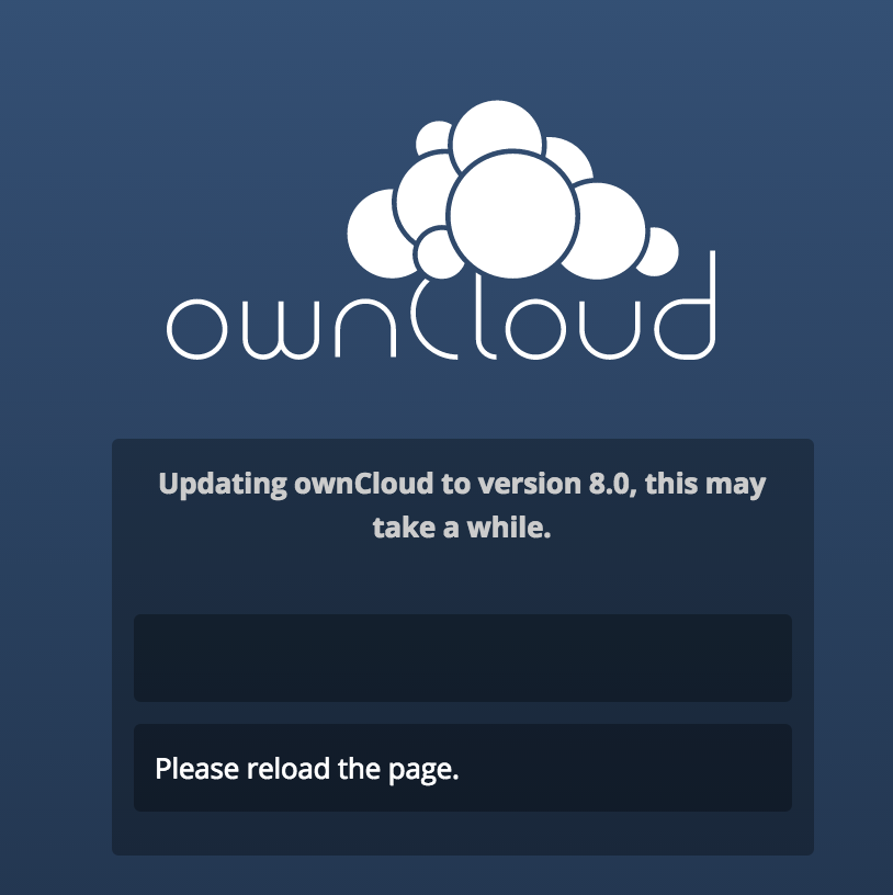

For me, it doesn't work.  It doesn't update.  I also modified my config to use owncloud with Apache Reverse Proxy, I don't know if it has any incidence on the upgrade.
I tried doing a docker exec -t ownCloud bash, then running ./occ upgrade, but it didn't work either, it just stuck and don't give any error at all.

I can't find any log except the docker run Log... For me, after I click the "start", it stay like that forever and never show any progress.  If I do a "reload", the start button reappear and I have to start it again...
58aad77034a8f_Capture_dcran_2015-02-12__19_52_45.png.7e7e5f1c875b4c4aff16baf34876263f.png
