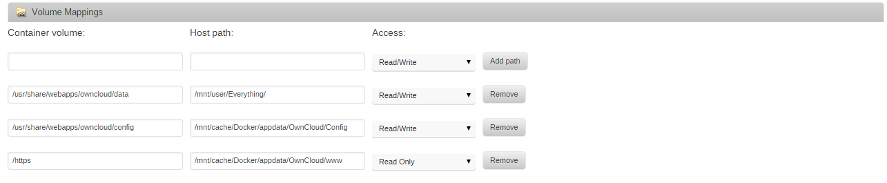

Any reason a config file isn't downloaded when I add this docker? I'm on Version 6 RC1 currently. It worked fine on an earlier version though I don't think it was unraid itself that made it work but actually having a config file.
Dockers don't really "download" a config file. The docker container has files, some of which are stored where you specify in your volume mappings. What are your volume mappings?
You will see the folders in the attached picture.
