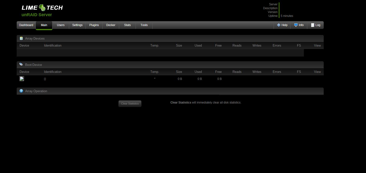

I updated earlier, but it seemed to 'fail'.  Someone suggested to just update again, and that did seem to work.  I stopped the array, then rebooted, all was fine.  Then I read a post in another thread about apcupsd needing updated, so decided I should do that.  I uninstalled the plugin, stopped the array, rebooted the server, and now I don't have access to the GUI.
I can see that it has finished booting, by looking at the monitor, but I still don't have access to any of my folders.  I tried connecting with Putty, and it warned me that the security credentials had changed and did I want to connect anyway, so I said yes.  Now, I see it's logging in with another server name...
Using username "root".
Linux 3.18.5-unRAID.
root@Tower:~#
Previously my server was named "Media".  I had the IP forced to 192.168.20.150, but that address does not show the GUI.
I cleared my cookies, tried again but still not working.  it did ask me if I meant to go to tower, so I said yes, but that failed also.
I do have putty access, but nothing else.
How do I fix this?
root@Tower:~#
How do I fix this?
root@Tower:~#
How do I fix this?
It sounds like unRAID isn't pickup up the settings in your config files on your flash drive. Assuming you're using Windows, try opening the network folder
\\tower\flash\config
Your server name should be in the file ident.cfg, line #2, with an entry of
NAME="Media"
Your IP address should be in the file network.cfg
Yours should look something like this:
# Generated settings:
USE_DHCP="yes"
IPADDR="192.168.20.150"
NETMASK="255.255.255.0"
GATEWAY="192.168.20.1"
DHCP_KEEPRESOLV="no"
DNS_SERVER1="192.168.20.1"
DNS_SERVER2=""
DNS_SERVER3=""
BONDING="no"
BONDING_MODE="0"
I wonder if the config folder got damaged somehow on your key?
I hope this helps you troubleshoot.
-- stewartwb
