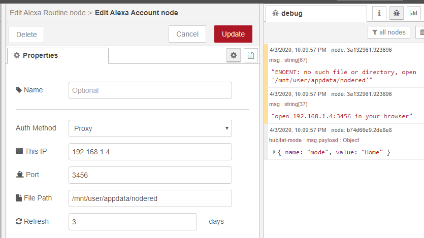

Hi Guys, Hoping someone could point me in the right direction, as i dont know if this issue is with the docker path or with the node palette!
I have installed the palette node-red-contrib-alexa-remote2
Inside the settings a path to save the amazon cookie to a text file, but no matter i put, i keep getting a path/directory not found error
Anyone know what i could try??
Install instructions i have seen say i should just put "authFile", which i presume would save it in the installation directory - but it doesn't
Cheers
Edited by bdydrp
I have saved a cookie.txt file in /mnt/user/appdata/nodered
and given user permission to match
Still keep getting "no such file or directory" error
I think you need to use the container directory. /mnt/user/appdata/nodered is the host directory that the container directory is mapped to. You can see the container directory from the docker settings. It's probably /data .
Edited by lsaranto
Exactly this.

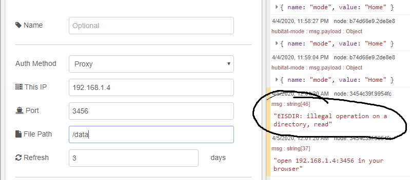

@spants
Ive changed the directory to /data
now i get this error
Cheers
Edited by bdydrp
In this screenshot, which line is the host directory?
../ or
Nodered red ownership should be 1000:1000
but not sure if my error is because the highlighted line is nobody:users?

The error i have above "EISDIR, ilegal operation on a directory,  read" i took as a permissions error as it cant write a file to /data. Which is owned by 1000:1000 - i thought whis was needed by the nodered documentation
I tried a completey fresh install without changing permissios but still got same error.
So now im not sure what to put in the file path location for that palette!
Edited by bdydrp

File Path is the place where you should type something/anything, meaningful to you like “authFile”. The plugin will create a file with that name and inside the file, it will store your encrypted Amazon credentials. This is needed because otherwise it will ask you to re-login every time you re-deploy your Node-RED flow.
So you should only put a filename in it, not a full path. Maybe.
41 minutes ago, lsaranto said:
Have you tried following the guides listed at the end of this page https://flows.nodered.org/node/node-red-contrib-alexa-remote2 ? In one of those guides it says:
Yes, ive looked at the guides.
authFile just gives me a "unexpected JSON end" error.
If i put any other path file - this returns a "no such file or directory exists" error
Ive tried many paths/filenames etc, but nothing works
Ill keep trying tho!
