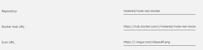

I get this now when I check for updates on my node red docker..
Is there a new docker for this or something?
Jim
No...  It's set to that..
wait..  It's a little different..
Ok..  that was it..  It must have changed from when I first installed it.  I changed the repo and now it looks ok...
Thanks for the help.

Had the same issue just recently too.  Not sure what caused it as i just updated it a couple weeks back and it was fine.
The node red team changed their URL..... I changed the template but existing users of a template do not get automatically changed by community applications app to avoid overriding existing parameters

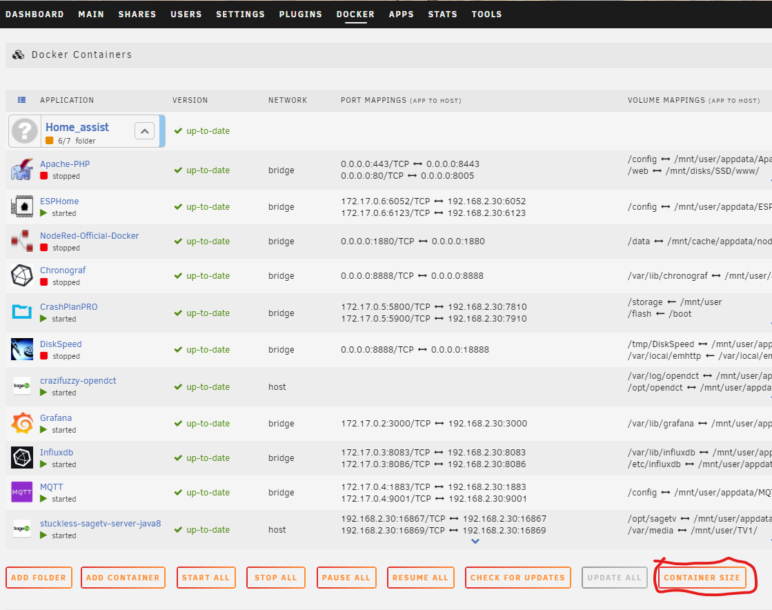

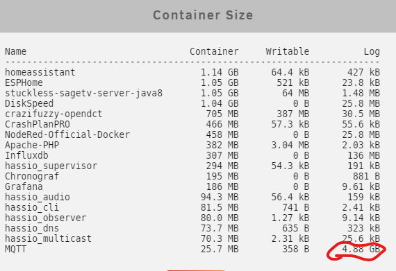

Another question..  My MQTT log file is > 4GB!  how do I get rid of it?
I don't have an answer to your question, but how did you get that output?
