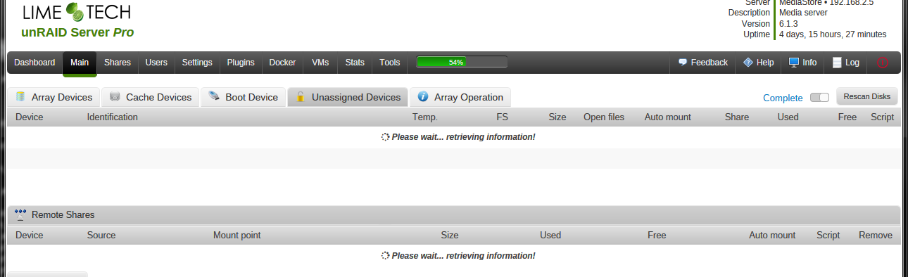

Just updated to 2015.09.24 and now it just sits there trying to find the devices
suggestions?
suggestions?
Please try today's update.
suggestions?
Same symptoms with 2015.09.25
