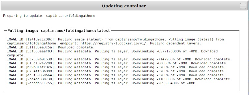

I encountered a minor Docker tab GUI issue while updating a Docker container. When pulling a fs layer, [in the attached jpg] the stats showed an impressive percentage in the downloading information. The container downladed fine in the end, but thought it worth the mention for you to be aware of.
FoldingAtHome was the first docker I had updated after updating unRAID to beta 15 (from 14b). My other dockers did not have this percentage display problem during their updates.
cheers,
gwl
Well apparently you're downloading is so good it goes above and beyond 100%!  [emoji6]
That is odd to say the least. Has it happened with any other containers?
cheers,
gwl
No, my other containers did not show the extraordinary stat during their updates.
cheers,
gwl
