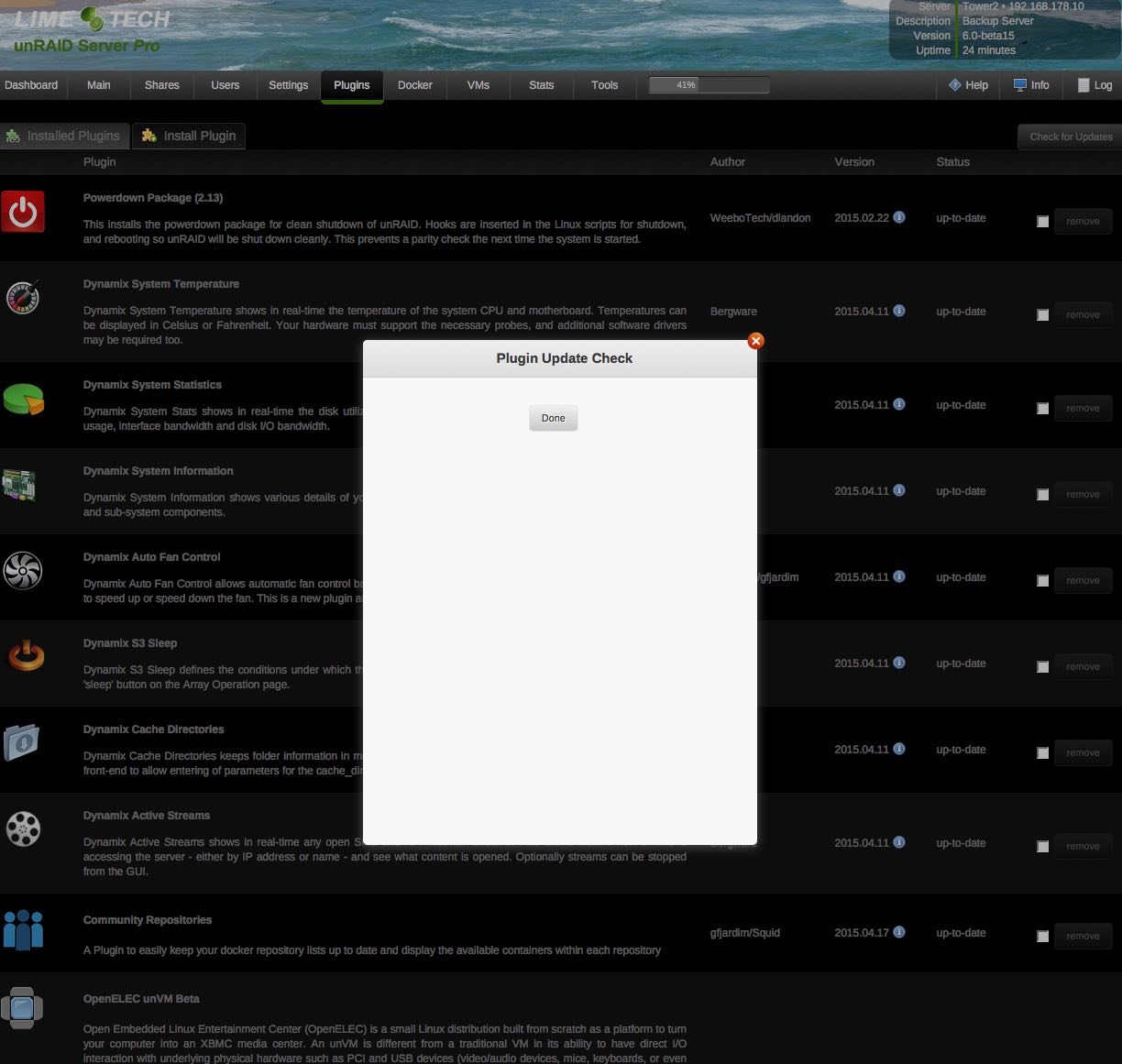

Updated my test server - all went fine. Thanks a lot for this great unRAID release.
VM's, Docker, all is working flawless. I have removed the vmMan plug-in and I see VM Manager icon now under "SETTINGS". That is correct?
The only issue that I see is an empty screen when I try to check is Plugins are up-to-date. Log is empty and not showing any error (..and yes I cleared my browser cache)
yes, i get the same.
Eventually it will finish and show a done button.
