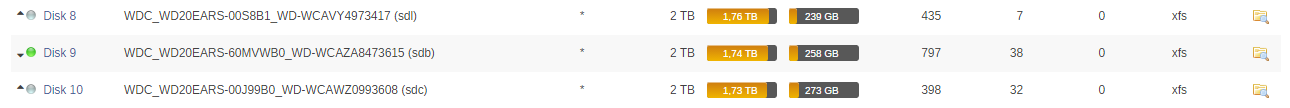

I have the situation that disk is up, but no temperature displayed.
hdparm -C /dev/sdb
/dev/sdb:
drive state is:  active/idle
Edit
Temperature appears after timer "poll_attributes" expires (in my case set to 5 minutes)

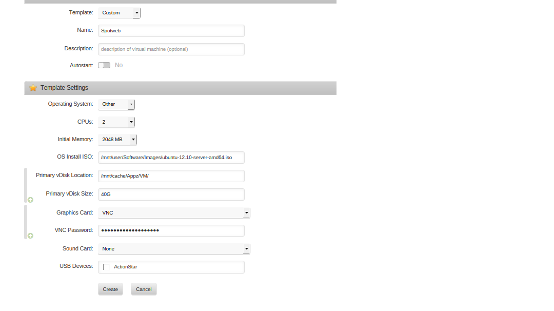

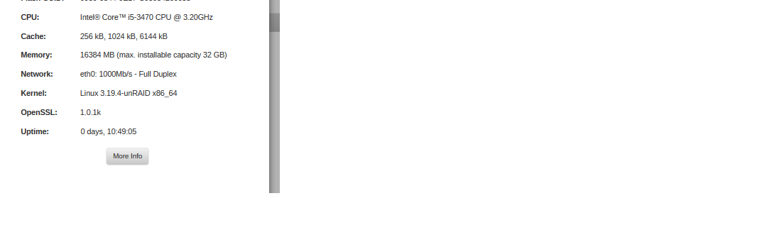

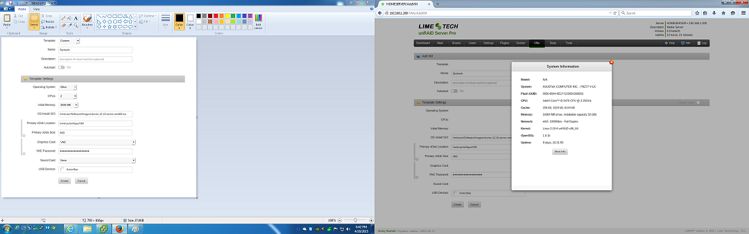

What ISO are you trying to use for the install media?
Here you go
I can't make out any of the text on either of those screenshots  :(
the memory usage bar on the dashboard is resolutely stuck at 30%
doesn't move at all, lol.
Let me try again
how about these
