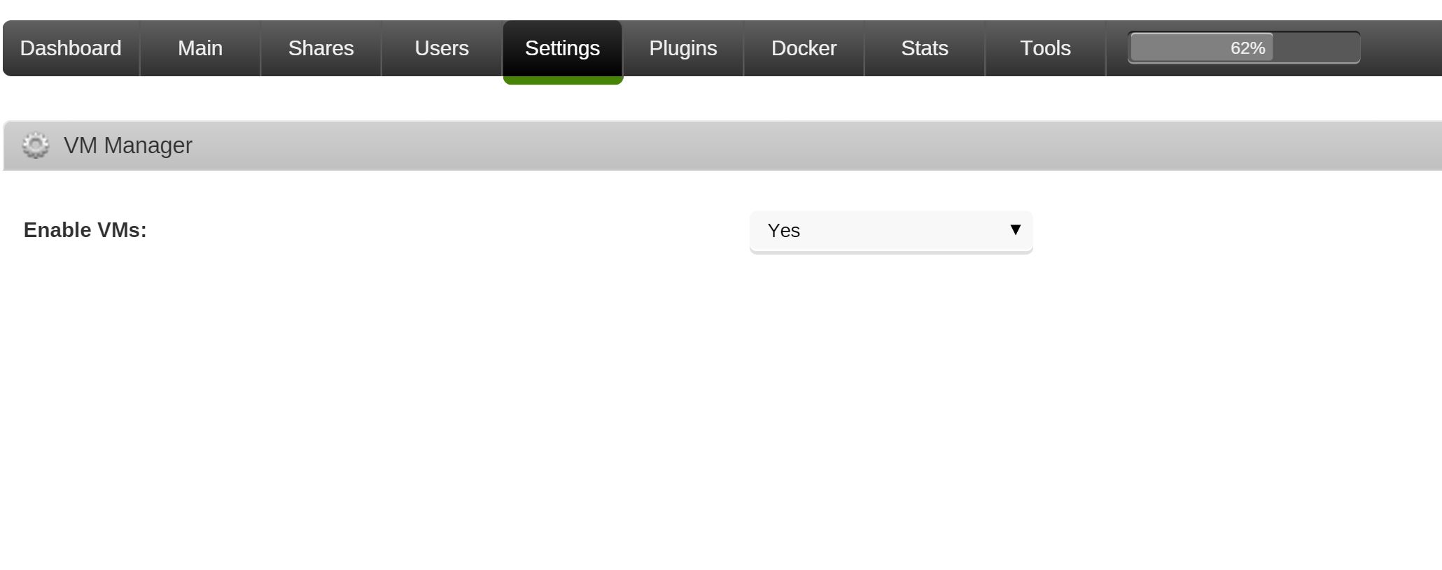

I understood that we were supposed to remove the VM Manager plugin before upgrading. I did that, but I don't have a VM Manager tab anymore. There is a VM Manager in Settings, but it doesn't seem to be working for me. When I first used it, it had several things to fill in on the form, and an Enable VMs dropdown. After filling it out and hitting apply, now it doesn't have anything but the enable dropdown and no way to make further changes (not even an apply button), and still no VM Manager tab.
I played with VMs a little on earlier betas, but have not been using them lately, and didn't have any configured before the upgrade.
I have also rebooted after discovering this, and cleared browser cache (chrome), but no change.
You appear to have other webgui plugins installed. Please remove them. Then see of this issue is resolved after another reboot.

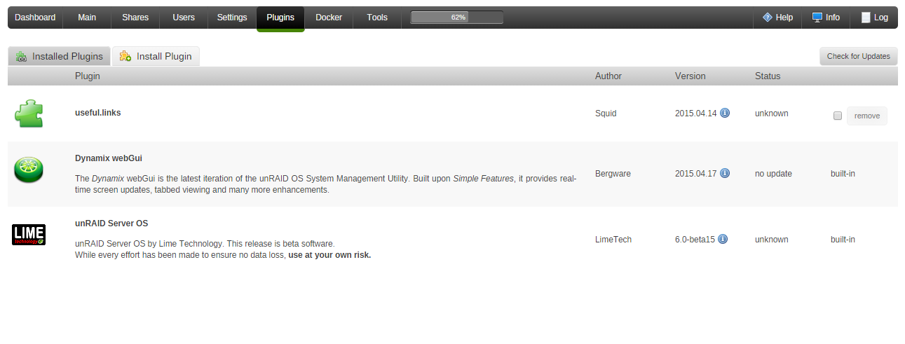

Removed all plugins, except Squid's Useful Links still shows on the plugins page despite not actually being on the Tools page anymore.
Rebooted, cleared browser cache, no change.
Obviously you found a bug in my uninstall routine.
EDIT:  Found it -> typo in the routine to remove the plugin.  Update available.

Are you booting into xen or kvm mode?
KVM

Hmm, anything odd in the log?
Maybe this
Apr 17 23:41:34 unSERVER logger: Starting libvirt
Apr 17 23:41:34 unSERVER logger: Starting libvirtd...
Apr 17 23:41:34 unSERVER logger: /usr/sbin/libvirtd: /usr/lib64/libvirt.so.0: version `LIBVIRT_PRIVATE_1.2.8' not found (required by /usr/sbin/libvirtd)
Thanks for finding that bug in my uninstall routine.  An update is available, but you're going to have to delete /boot/config/plugins/useful_links.plg  and then reboot.  Nothing strange will happen if you don't (beyond not being able to reinstall the plugin since Dynamix thinks its still there).  The fixed plg file is already available
Fixed it. Had another libvirt hanging around in extra. Sorry.
NP. Glad you got it sorted!!
