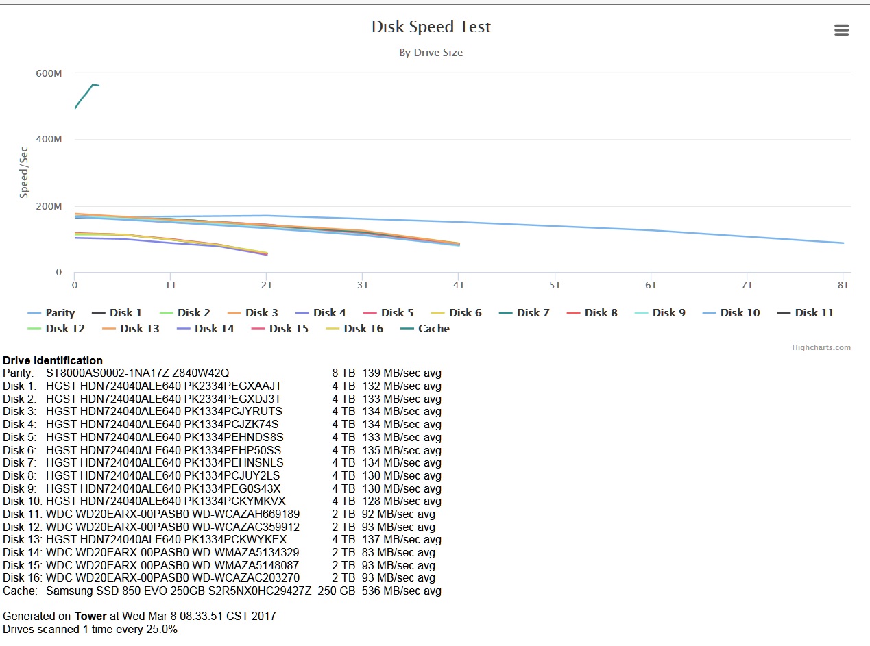

I have a mixed array of 2, 4, and now 8tb drives and thought I would do a little testing.
First off this is my initial build. http://forum.kodi.tv/showthread.php?tid=143172&pid=1229800#pid1229800
Since then I have replaced the CPU with a Intel® Core™ i5-3470 and just recently replaced the cache drive with Samsung SSD 850 EVO 250GB along with a new Seagate Archive HDD v2  8TB 5900 parity drive.

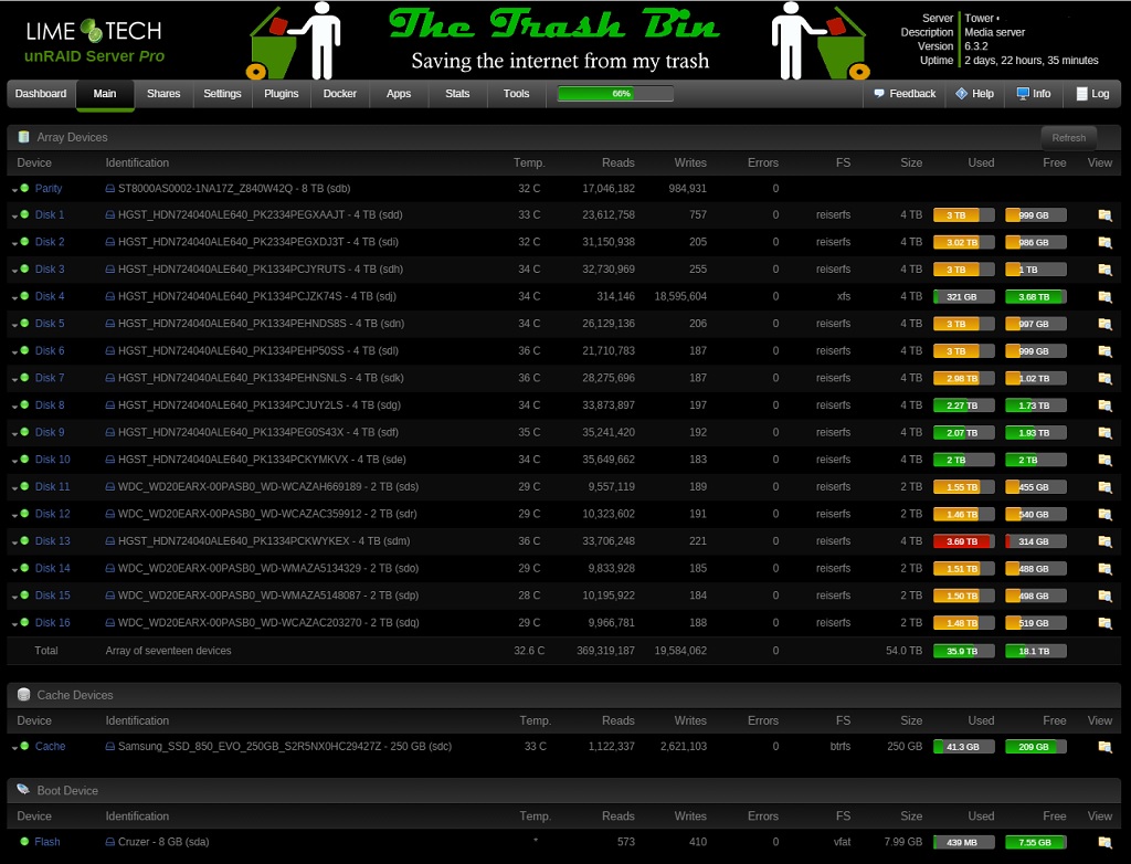

Here is what my array looks like ...just FYI...

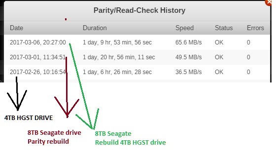

So here is a pic of my parity history with the 4 TB against the 8 TB.

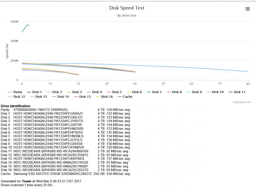

So after reading about how fast everyone's parity checks were going I decided to run a speed test on drive. here is the pic
You can see that the 8TB holds up well and the 4TB are cruising along but the bottle neck are the 2TB drives I have.
I have ordered 3 more 8TB drives and am hoping to replace the 2TB drives. Then add a second parity drive.
Just thought I would post this for info.
If the SASLPs still are in the slots pictured your main bottleneck is slot PCIE3, then the DMI, if still available use the top PCIe slot (PCIE1):

Well my end game plan is to rid myself of drives and move 6 drives to sata on M/B. I could then take one SASLP card out. I then could move to the PCIe 1 slot for remainder of the drives, if I keep this case and config. But I do understand the bottleneck with what you are saying. Just at the time of build wasn't thinking I would need much more storage. oopps.
If you want to improve parity check speed with current setup try this:
6 disks onboard (use your fastest disks only, 4 and 8tb)
6 disks on SASLP #1 using PCIE1
5 disks on SASLP #2 using PCIE4
Divide slower 2TB disks by the 2 SASLP evenly.
With the right tunables this should give a starting speed of around 100MB/s, eventually decreasing a little during the first 2TB but speeding up considerably once past that mark, total parity check time should be well under 24 hours.
