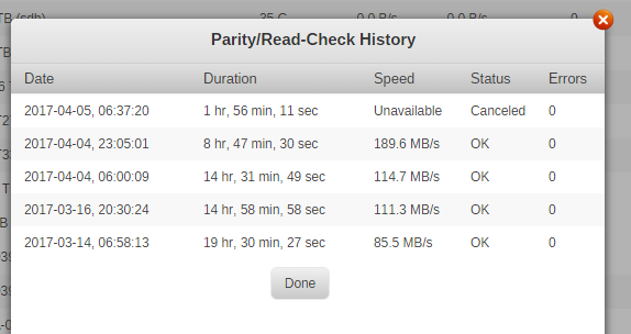

12 hours ago, danioj said:
OK - sorry all, I completely screwed that post up. Please let me assure you, it was all coming from a good place. I didn't realise that clears were recorded in the parity check log as well.
NB: I think I will be asking LT for a change to the logging to indicate what it was that was actually run. But Ill get to that later ....
So based on my log and the timeline of events (before I edit the post again and get it wrong) my log is this ....
2017-04-03, 16:22:17 19 hr, 48 min, 40 sec 112.2 MB/s OK 0
2017-04-02, 19:13:52 22 hr, 54 min, 43 sec 97.0 MB/s OK 0
2017-04-01, 21:00:28 20 hr, 30 min, 27 sec 108.4 MB/s OK 0
2017-03-30, 09:57:57 14 hr, 59 min, 16 sec 148.3 MB/s OK 0
2017-03-29, 18:35:46 21 hr, 3 min, 48 sec 105.5 MB/s OK 0
2017-03-01, 20:02:50 19 hr, 32 min, 49 sec 113.7 MB/s OK 0
I am confused if Clears are logged as well why there are not more entries.
I did the following (working from the bottom up):
- Added new 8TB parity disk (no clear was required just a sync) - I assume that was entry 2
- Replaced 3TB data disk with another 8TB disk (required a clear)
- Disk rebuild 3TB disk => 8TB disk
- Parity Check ran in that time - I assume that was entry 4
- Replaced 3TB disk with another 8TB disk (required another clear)
Given that list of events I am finding it difficult to see what that 148.3MB/s is? If it was a clear then surely I would have a similar one as I added a second 8TB disk that required a clear. I am confused.

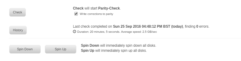

I just thinking those abnormal result and try to reproduce. I belive those relate some calculation bug, but not sure only happen in 6.3.3 or not. ( BTW this may not be same as OP case )
Say short in long, I force unRAID belive the array ( with 6TB parity ) was clean, then I make a 3TB disk disable and add again, so it will perform sync on that 3TB disk. In fact, the max speed just ~110/MB/s ..... after complete, the result will be like that. The calculation wrongly count by 6TB instead of 3TB.
Edited by Benson
Yes, that's an old bug, not related to the case above, but it does provide some interesting results :o
