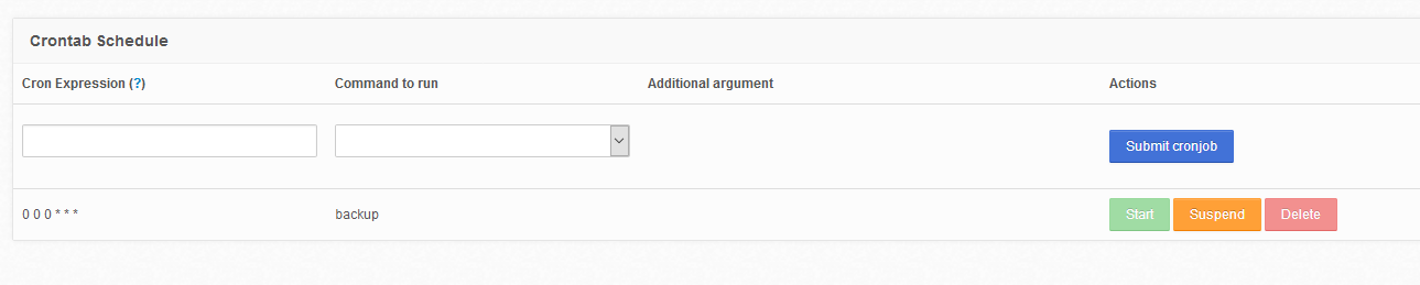

Is Mineos supposed to automatically save the server?  If not what specifically do i do on the scheduler?
No, nothing is done automatically by default.
If you want to create a restore point every night, you can add a new schedule. The cron expression should be  "0 0 0 * * *" and the command should be "Create a new restore point" which ends up being "backup" in the list for some reason.
That will create a restore point at 00:00:00 (hours, minutes, seconds) every day of every month, every year.
Once you hit submit, you need to start it, otherwise the job will not be run at the desired time.
You can see my example below:
Edited by SelfSD
Forgot a word
How do i restore now? i rebooted and mineos has no sign of any servers?  i did the cron job.  thanks in advance.

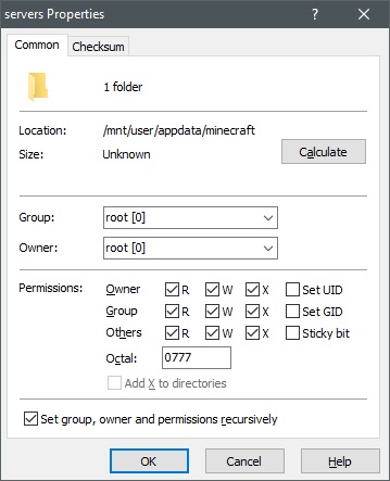

If you browse to /mnt/user/appdata/minecraft/servers, do you see the server folder and contents there? If you do it's a permission problem. I had to change the permissions on all the folders and files inside the minecraft folder to 0 for MineOS to be able to read from them.

I think I miss worded permission with owner. My bad.
Try setting the owner and group to  root 0 and the permissions to 0777. I'm not too familiar with Filezilla but if you have the options to set permissions to subfolders recursively , check that so all the files inside the folder gets these permissions too.
Yes filezilla does do it recursively, however it doesnt seem to let me change ownership, how are doing so in that picture ? , im doing this remotely over VPN
Edited by loady
I see you used winscp, I have just done exactly the same as your screenshot but still servers are not being read from folder..I also tried removing docker and adding again
