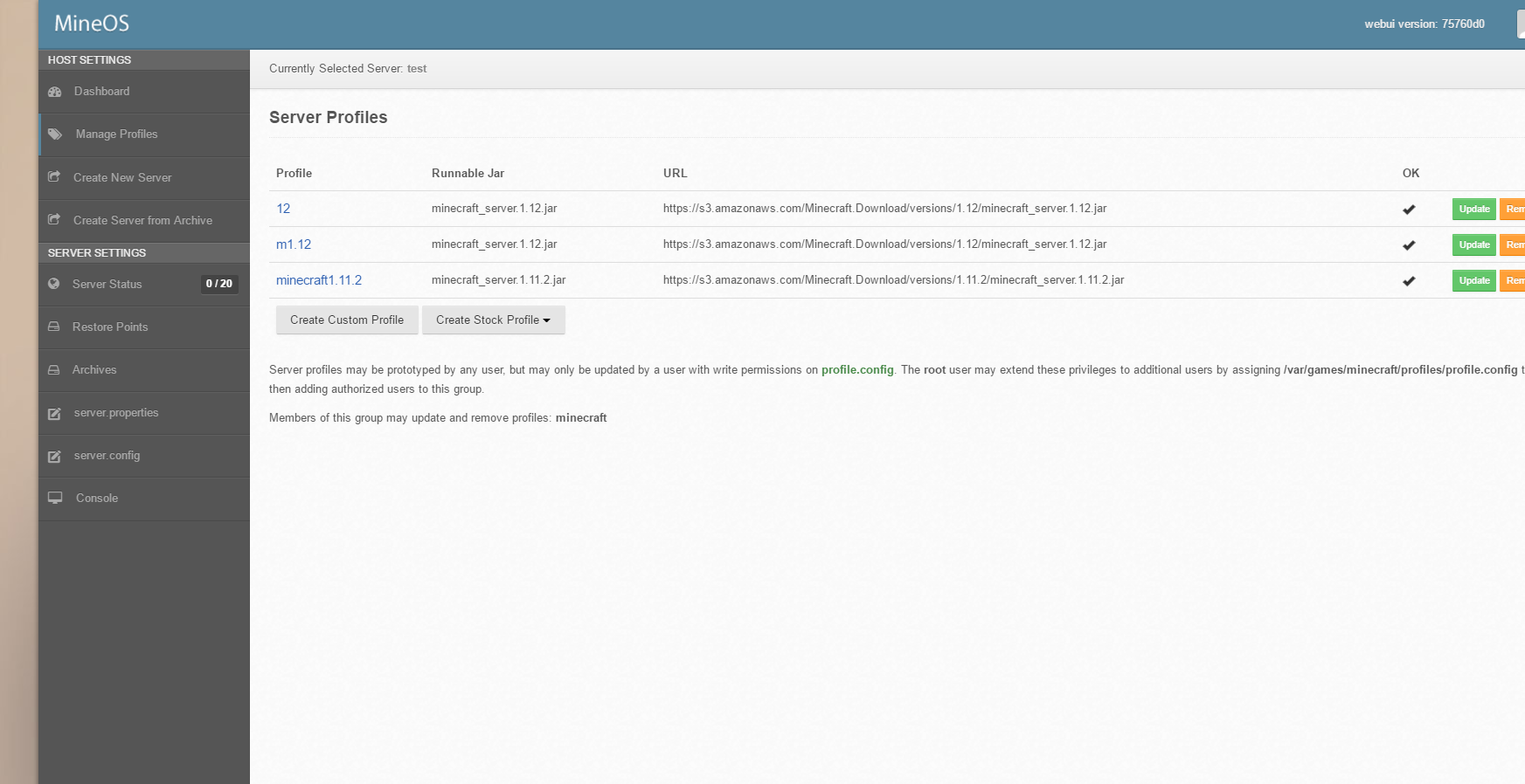

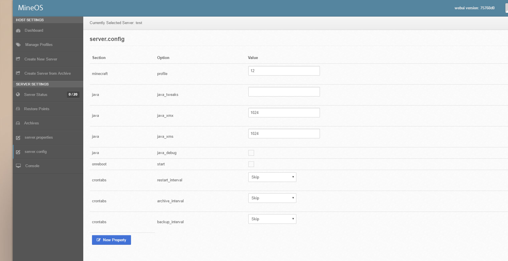

I've been successfully running a couple of minecraft servers for a couple of weeks now using the 1.11.2.jar file.  I'm trying to upgrade to 1.12 but it's not working - I can add a new profile, but when I try to change a server to use the new profile it won't start - what am I doing wrong?  Need help as got cranky kids now.  I can't even get a new test server to start using the profile
Thanks
1.thumb.png.7bfd01f9d972ca1f8fe996b23a1b906b.png2.thumb.png.564de801e5a83da41b1775cc3bf7376c.png
@DZMM Ditto.  same exact problem.  Well pretty much the same.  Mine says "Started" in the little box on the lower RH corner but the server itself doesn't actually start.  Same thing I tried a new test server and it didn't work.  So take comfort that you're not alone.  At least it comforts me I spent 90 minutes dorking around until I looked here.
I'll add this.  The  minecraft_server.1.12.jar file I'm using I downloaded from here:

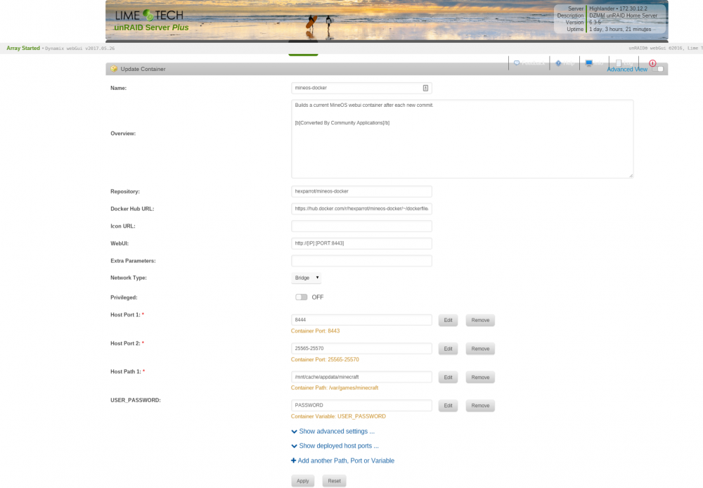

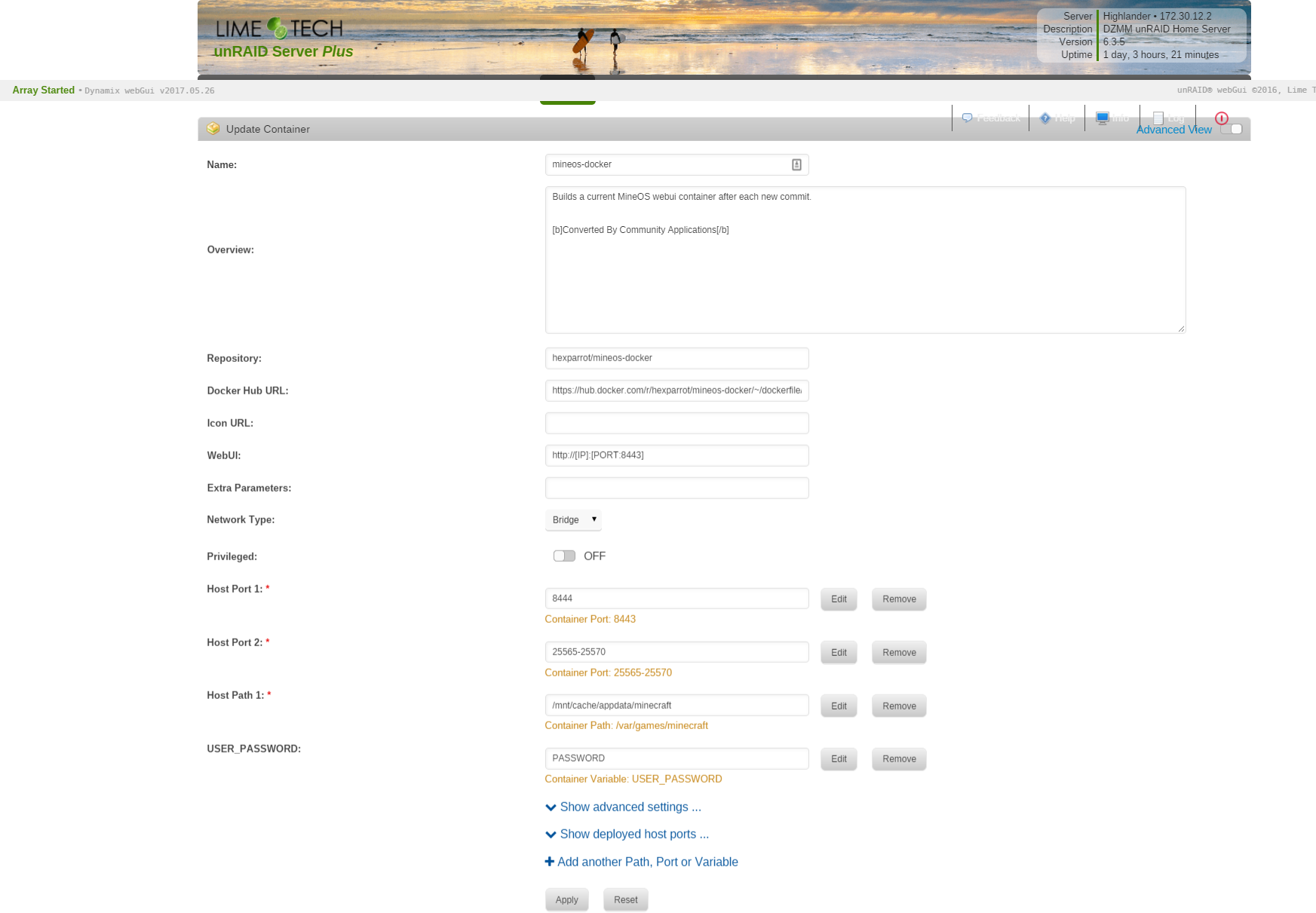

Hi Squid, thanks for your help.  I'm still having trouble:
1.  I uninstalled my existing Mine OS docker.
2.  Followed your instructions getting additional results and searched hexparrot and get more results from dockerhub.
3.  Picked hexparrot's mineos-docker
Note:  I couldn't create it at first because I needed a "Host Path 1" (it was blank) so I put in /var/games/minecraft as the text suggested.  Then it loaded up but wouldn't  start saying it needed a password (according to log).
4.  So I edited the docker and added a variable USER_PASSWORD and gave it a password.  Now under my Unraid server "dashboard" I have "mineos-docker with a green run arrow so I assume it is running.
5.  But when I go to the WebUI and it tries to open the minecraft port on my unraid IP I get "this page isn't working.  192.168.x.x:XXXX didn't send any data.  ERR_EMPTY_RESPONSE.
Note:  I can start and stop the docker just fine.  Just can't get to the WebUI.  Not sure what to do next.  Or is that a separate docker?

here are my docker settings.  I changed the host port to 8444 as I have another docker on 8443
Remember username is mc with this docker
Thanks for your help everyone!!
@DZMM Your screen print definitely helped me.  I think I had two issues:
1.  I had the host path 1 = /var/games/minecraft.  I replaced that with your text:  mnt/cache/appdata/minecraft  <--(I think this was a big deal, right?)
2.  I had the port 8443.  I changed to 8444 like yours. <--does this really make a difference?
After clicking webui after making these changes, I still couldn't access. However, this time when I physically add https:// then it give me an except saying "not safe" which I ignore, and after ignoring it starts mineOS (yay!!).
Is there a way that I can have it automatically go to https:// when I click on  webui because when it simply opens up 192.168.1.99:8444 it doesn't work at all.  when I manually ad https://192.168.1.99:8444 in front I get "insecure site" and I can bypass and it works.
Or... am I missing something?  I think I'm working now but I want to understand, and I want it set up right :)
