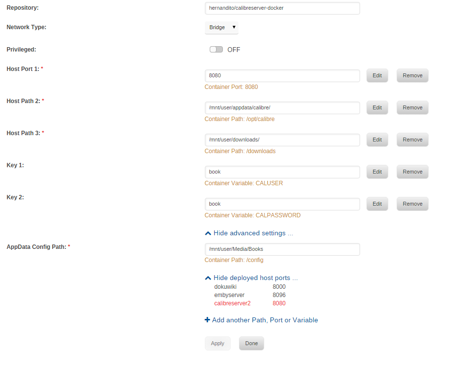

I have installed the Calibre Docker and the web interface will not start; I go to the webpage http://ServerIP:8080/#/, started from the unRAID dashboard icon, just a blank page.
Not sure why "/#/" is appended on to the web IP?
Here are my settings if it helps:
Edited by whwunraid
