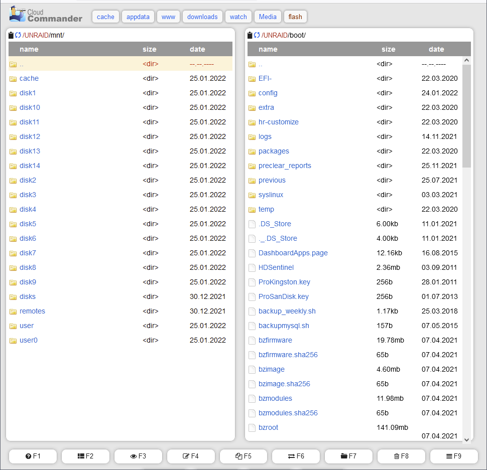

I have added a new docker: CloudCommander. It is a modified version of coderaiser's CloudCommander. I have modified the Docker itself to improve on the GUI. I have also added a way to manually modify the shortcut links to your own requirements. Here is the GUI.
I hope you get good use out of this guy.
