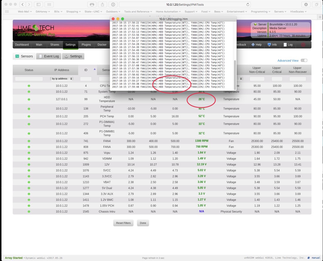

This question may have already been asked, but I couldn't find it. Why is there such a large difference between the HDD temp shown in the sensors page/footer and the HDD temp shown in the logs? 26C vs 38C. Aren't both readings being taken from the same sensor?
BTW- All my drives are spun down currently except cache (26C) and one external drive mounted via UD (38C).
Edited by wgstarks
The Sensors page takes the highest hard drive temp from the already available /var/local/emhttp/disks.ini. I didn't want to re-poll the hard drives since they had already been polled.  This however only includes array drives.  The fan control script takes the highest temp from all drives.  That's the reason for the 38 in the fancontrol log and 26 in the readings.  There was some talk recently about possibly adding an ignore function to fan control.  This would keep fans from spinning up due to external or preclearing  drives. That's on my todo list. Similar to the dropdown checklist for sensors but for hard drives.
Edited by dmacias
