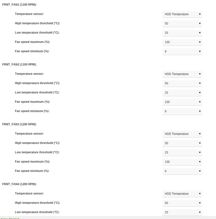

it is in /dev but not under sdx, nvme0n1.  After rereading your post it makes sense,  as long as temp fan control is based on my spinners and not on my NVME I'm good with that!

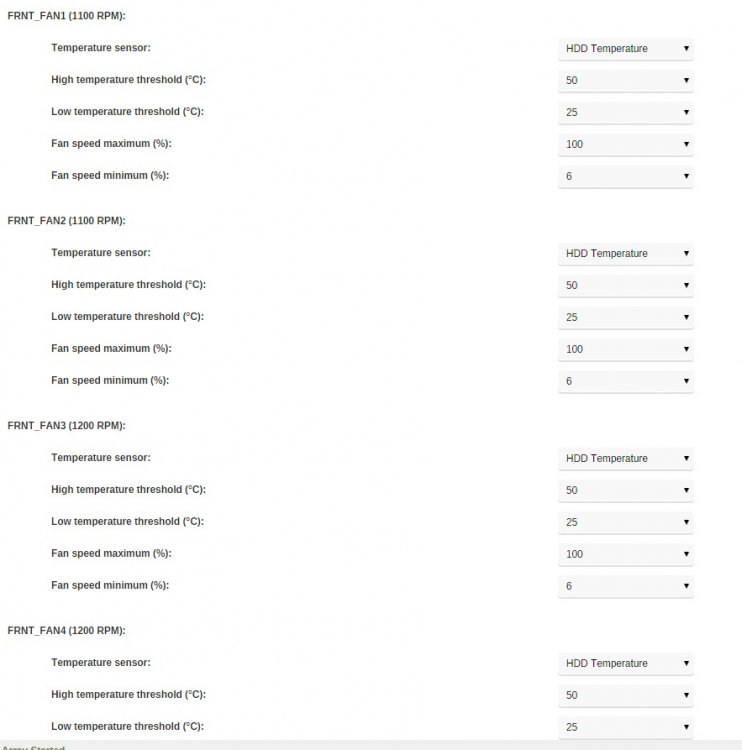

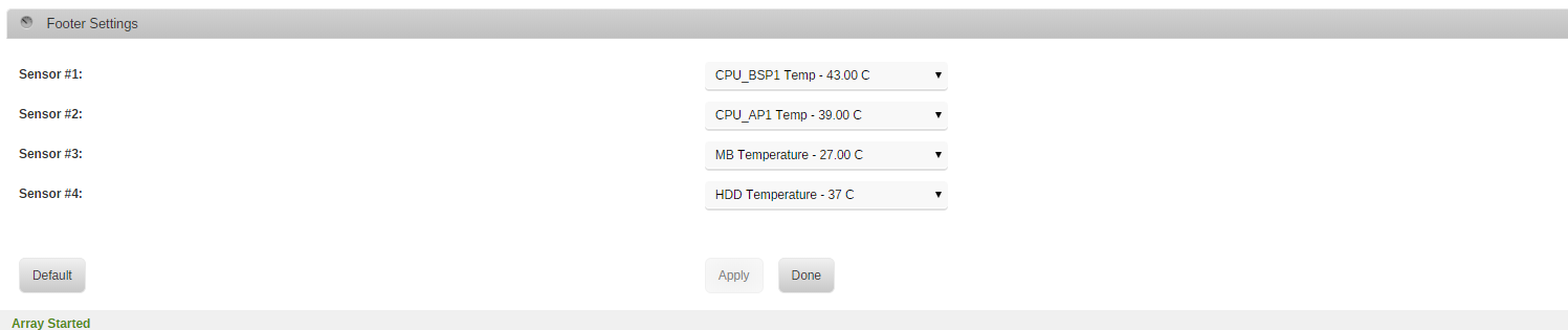

ASRock EP2C602 should work now with fan control. Just click the Configure button first to setup the fans. If it's not working then to debug, you can stop the service in the webgui and run "ipmifan --debug -f" and let that run for a bit. It will log the actual command used in the fan control log plus print out all the variables.
Thanks for your help,  I think I figured out its my ssd thats not in the array that its reading, I set it to ignore the disk but we will see, again thanks
