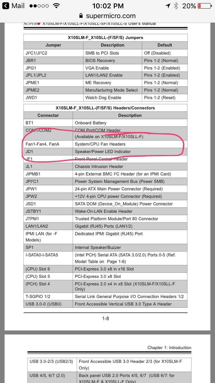

When I got my X10SLL-F board it would boot up and all the lights looked good but no video post. I couldn't connect to ipmi either. I thought the bios might be old and not compatible with my processor. So I was kinda stuck. I had to use wireshark to sniff the ip of the BMC. And found there was a manial ip set. The bios and BMC were latest versions though. It turned out the power supply was bad.  But I did factory reset the BIOS and BMC.  Here's what my sensors config file looks like

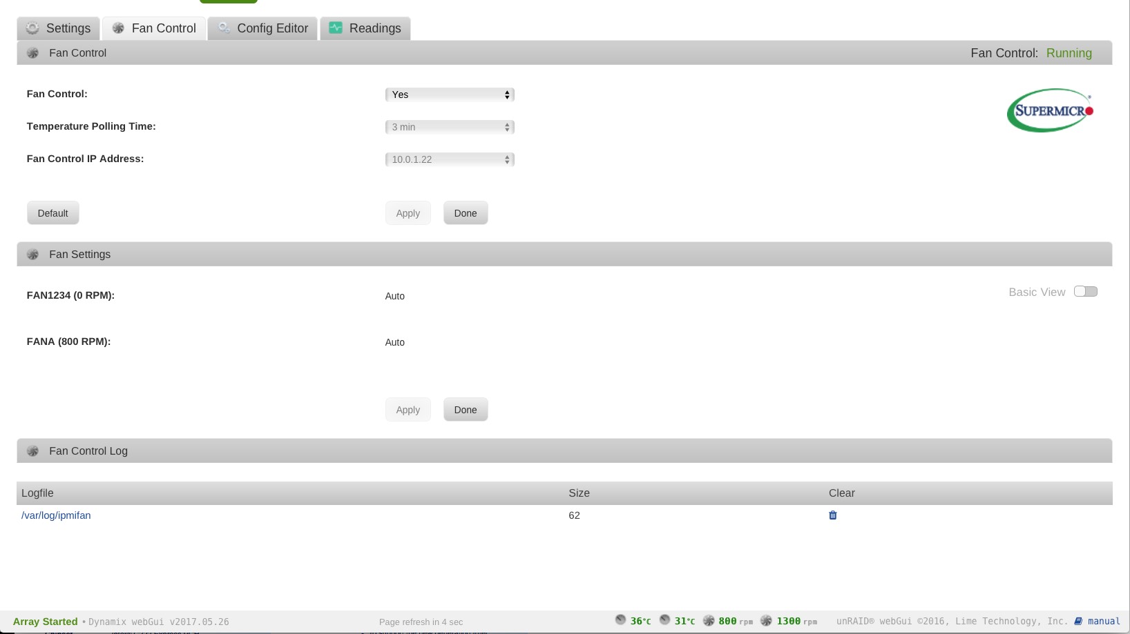

So I'm missing details on fan 4. Originally I had fans connected to FAN1,2,3 and A. I had changed my fan arrangement and moved my CPU fan to FAN4. So FAN3 is empty.  So the previous config is from the original fan configuration. I clicked on the REVERT button on the Sensors Config Editor page, which pulls a new config from the BMC. This is what I got.

Did you try the Revert button on the Sensors Config Editor page?

58 minutes ago, jang430 said:
Is there a way to just lower the speed for the CPU fan, and not affect Noctuas' maximum speed at 1275 RPM?
If you have all 3 Notcua fans on FANA setting the profile to "Heavy IO" should keep those at or close to maximum speed while keeping the CPU fan at about 50%.

Decided to give it a test run. Seems ok. When i started fan control it kicked everything to max for about 2 seconds. Generated a couple of overspeed warnings. Then went back to normal.
Fan 1,2 & 3 are not connected to PWM fans but fan 4 is. Why don't I get a reading. I can see the speed in the footer and adjusting the minimum speed changes the fan speed.
Would also prefer to let the board control FanA (cpu fan). Is that what auto does?
Edit: Had to disable (uncheck) Fans 1, 2, 3 in global settings. Now have speed display for Fan4 although the label shows FAN1234.
Curious how this is going to work once I install PWM fans on 1, 2, 3. Those fans will be HDD cooling while FAN4 is my rear case fans. Different size and maybe different mfg.
Edited by wgstarks
The FAN1234 is just a the group. The fan speed that is shown is only for the first fan available I the group. That's why hiding the other fans shows rpms. It's really just a reference and is never updated unless you refresh the page. I was thinking of just picking the highest or getting rid of it altogether.
I need to double check the auto to make sure I'm using the right value. But auto right now sets a value of 01. Edit: 00 or 01 does not equal auto. 00 is auto for ASRock.
You also might check your manual but I'm pretty sure FANA is for I/O but not sure what temp sensor it's based on. I believe FANS 1, 2, 3 & 4 group are based on cpu temp. There was some discussion a few pages back.
Edited by dmacias

I believe I'm interpreting this right. 1234 are system A is CPU.IMG_1001.thumb.PNG.9f88ccb249801ba4708adcbb9c5e13bd.PNG
I'm not sure. I see what you mean but I'm not sure 1-4 = system and A = CPU. I got this from their fact. I know its from a different Motherboard but I have seen similar. Sometimes it seems like there's some conflicting info.
pixel.gifQuestion
We have a X9SCL-F and connected Chassis fans to FAN-1/2/3 and CPU fan to fan header "A" on this mainboard. Now we see that the fan spin up/down, or sometimes full speed. What can we do?
pixel.gifAnswer
FANA is for add-on card and controlled by system temperature. FAN1~4 is controlled by CPU temperature. CPU Heatsink fan should not be connected to FAN-A. CPU Heatsink fan can be connected to FAN-1. Chassis fans can be connected to FAN-2~4 or FAN-A.
Edited by dmacias
Usually FANA is for peripherals, but since there's only one of those most people use FANA for the CPU and the other 4 for peripherals, so it would be nice if the script had and option to reverse that so that FANA responded to CPU temp sensor and the other fans to disks temps.
Ignore that, I see you can already select the temp you want that fan group to respond to.
Edited by johnnie.black

I'll have to do some more digging in the user manual for my X10 but I'm fairly sure that FANA is specified for CPU somewhere in there. It's been a few years though so I could be wrong. Regardless, it's CPU now and working from CPU TEMP.
I wouldn't worry about it. If it's working fine. My manual looks just like the picture you posted but says nothing else. I was just going off other manuals and the faq. I was just worried it might be running off system temp instead.
