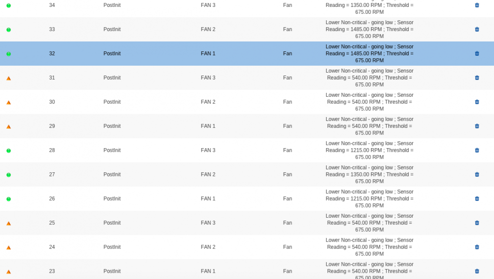

I wonder why, but nothing is showing up in the events log even after 2 hours or so.
Not sure, but your fans are going to low in any case, they are dropping below 500rpm, and unless they are very big fans they won't cool much at these speeds, you should get fans that don't go below 800/900rpm with low pwm settings.
If you're using the Optimal profile you can try switching to Standard and see if there's any difference.

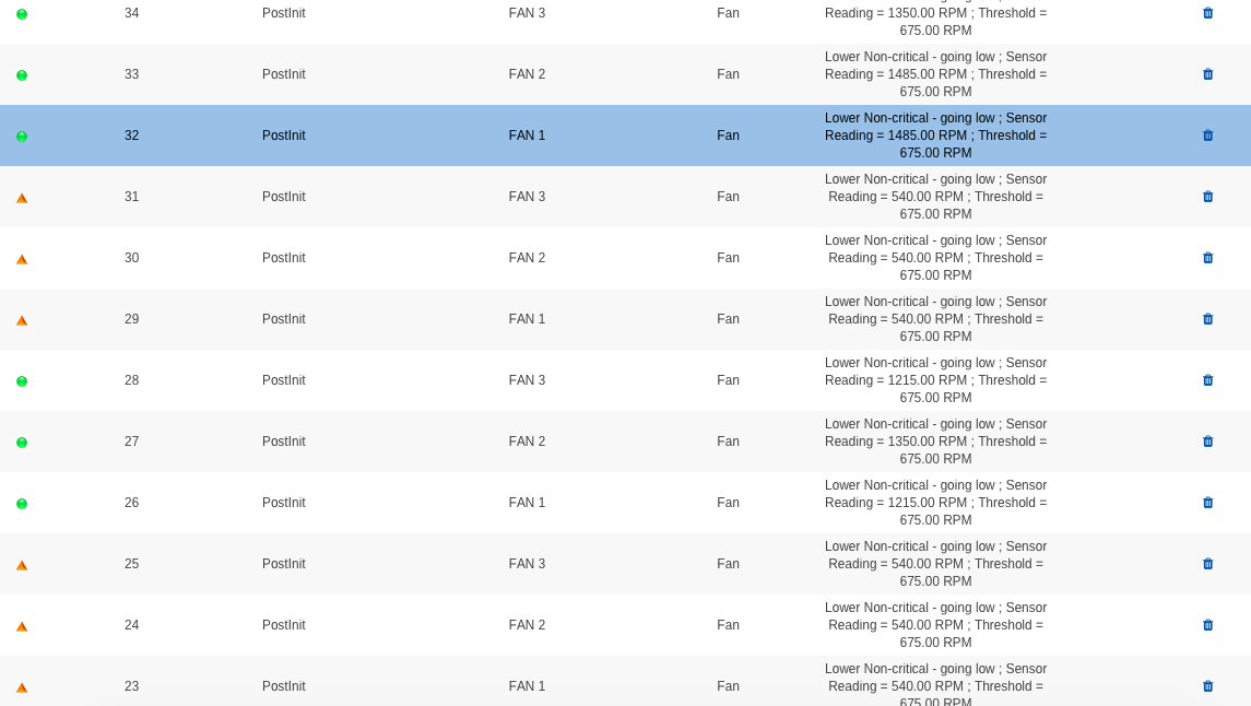

Hi.  Saw some event logs today.  Any other possible theory?
Not really, it's going lower than non-critical, that shouldn't cause fans to ramp up, are you using latest bios and BMC firmware?
I thought a drop below any threshold on these boards would ramp up the fans until the bmc realized the temp was fine. Then it would drop the rpm and begin the cycle again of lowering and raising the rpms.
It doesn't on mine, there's only the warning on the log (orange triangle), only when it drops below the critical threshold the fans ramp up (red x on the log)
