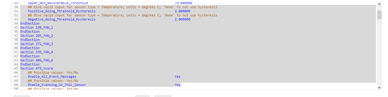

The same happened on one of my servers, there was only data for one of the fans, you can do it on the console:
1) download current config to a text file
ipmi-sensors-config --checkout --filename=sensordata.conf
2) use an editor like nano to change the values you want
nano -w sensordata.conf
ctrl+o to save, ctrl+x to exit nano
3) commit the changes
ipmi-sensors-config --commit --filename=sensordata.conf
Edited by johnnie.black

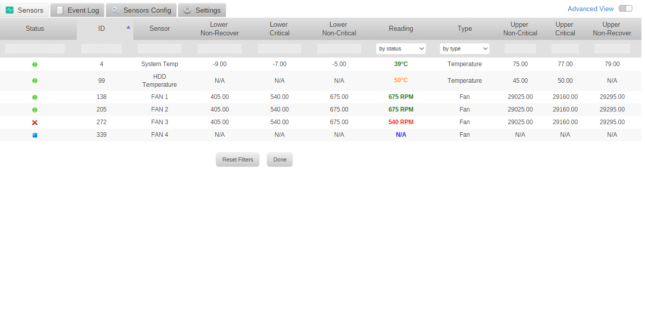

Which fan is revving? Looks like the ipmi status is showing that fan3 has failed.
I believe all. That screenshot was taken earlier. They all go up and down
Sent from my LG-D855 using Tapatalk

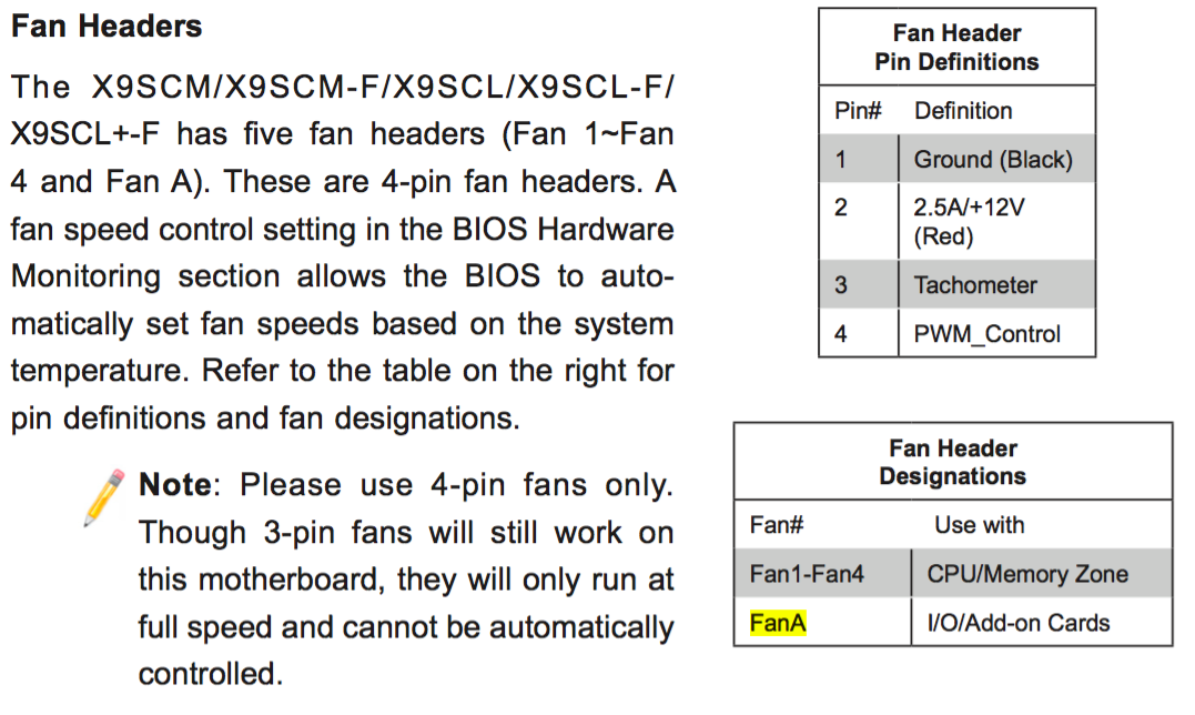

I'm reading around, and saw others say that Fans 1-4 are based on CPU/ memory zones, and FanA is for use with I/O/Addon cards.
This I cut from my manual- "A fan speed control setting in the BI S ard are Monitoring section allo s the BI S to auto- matically set fan speeds based on the system temperature. "
I wonder if this has something to do with another problem associated with these settings?  My fans, as of the moment, run at 540 RPM, but my HDD temperatures are "HOT, HOT, HOT!"  I've already taken my NAS out of the shelf where it's supposed to be, and the back and front is unobstructed.  Does it mean CPU fan should be connected to Fans 1-4, and HDDs should be connected to FanA?  Specially my case, Fractal Design Node 804 having 2 zones?  Motherboard zone, and HDD zone?  Hoping to hear more insights from you guys.

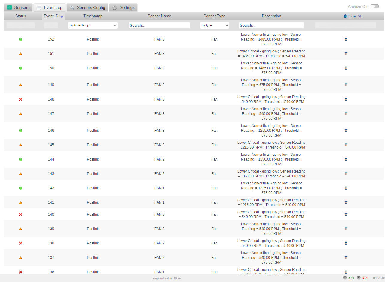

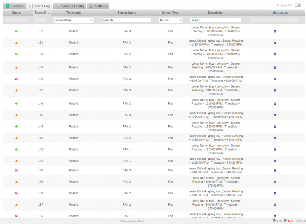

Something still wrong with the thresholds, on the IPMI settings, clear the event Log, browse to main page and then go there again after a couples of minutes and post the log.
Hi johnnie.black, Here is my latest screenshot of logs.
As it's visible in the logs fans 1, 2 and 3 are going lower than critical, which is set at 540rpm, you need to lower that, set lower critical at 300 and lower non-recover at 0 or 150.
I just changed Lower Critical to 270.  My current numbers are 645, 270, and 0.  I did it for all Fans 1-3, and Fan A.  Nothing connected to Fan 4, so I didn't change it.  It still goes up to 2025, all the way down to 405/540, then jump up once again to 2025, then slowly down again.
Clear the event log and post it again after a couple of minutes.
