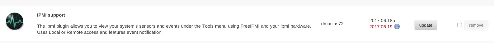

I see there is an update ready, but when I tell it to update, I get this error,
plugin: updating: ipmi.plg
plugin: downloading: https://raw.githubusercontent.com/dmacias72/IPMI-unRAID/master/archive/tablesorter-2.27.6-x86_64-1.txz ... failed (Invalid URL / Server error response)
plugin: wget: https://raw.githubusercontent.com/dmacias72/IPMI-unRAID/master/archive/tablesorter-2.27.6-x86_64-1.txz download failure (Invalid URL / Server error response)
I pulled the update. There should be a new update reverting the changes. I need to investigate more the impact of running the fan control script in intervals less than a minute. The script uses smartctl to get the highest drive temp. I was starting and stopping the script a lot, testing some settings and apparently one of my parity drives got a sata error. I didn't notice this till this morning after the mover caused parity errors on that parity drive. I'm not sure if they are related but I decided to pull the update till I can look through the logs. Also check why I wasn't notified till the parity errors. I would like anyone using the beta to update just in case.

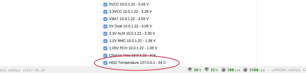

22 minutes ago, dmacias said:
The highest hard drive temp is injected as a sensor when I get ipmi sensor readings. So it shows up like an ipmi sensor.
Just want to be sure, is this the correct temp?
That temp is the highest hdd temp pulled from from unRAID webgui. It may differ depending on when it was polled and when the webgui actually pulled it from the hard drive.
Thanks. I actually had thought it was a physical sensor in the drive bay (glad it's not). Was wondering how it was connected to the mobo.:$:D
