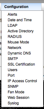

ok that board seems to have IPMI.
Please take a look at your IPMI WebGUI, do you have the Fan Mode option at the Configuration tab?
5932b45a14ffb_Bildschirmfoto2017-06-03um15_04_53.png.bd6b7da4d8d4337a73375c19bd6361cc.png

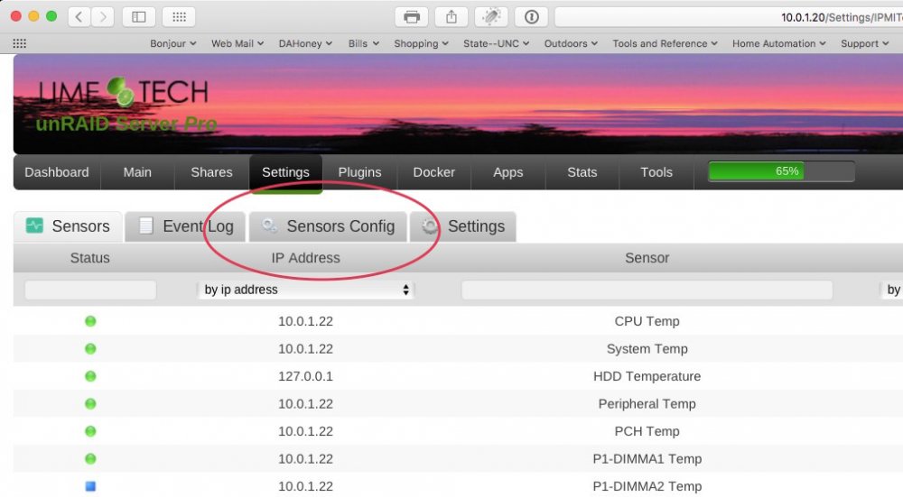

13 minutes ago, johnnie.black said:
Saarg already told you where to set them: settings -> ipmi - readings -> sensors config

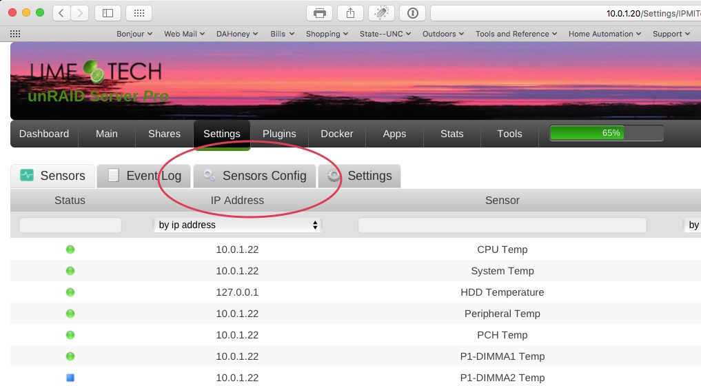

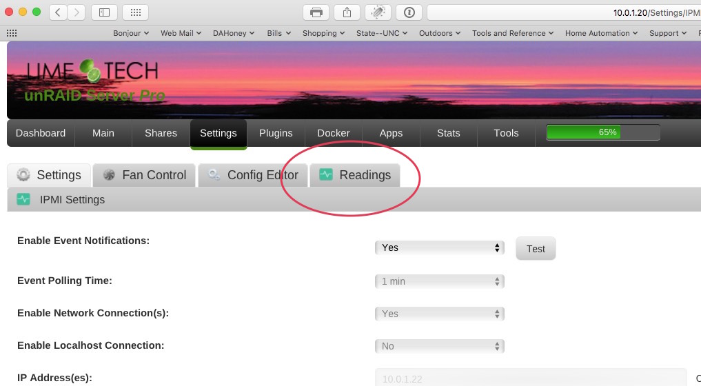

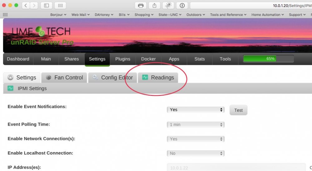

When you go to settings click the "Readings" tab-
Then select "Sensors Config"-

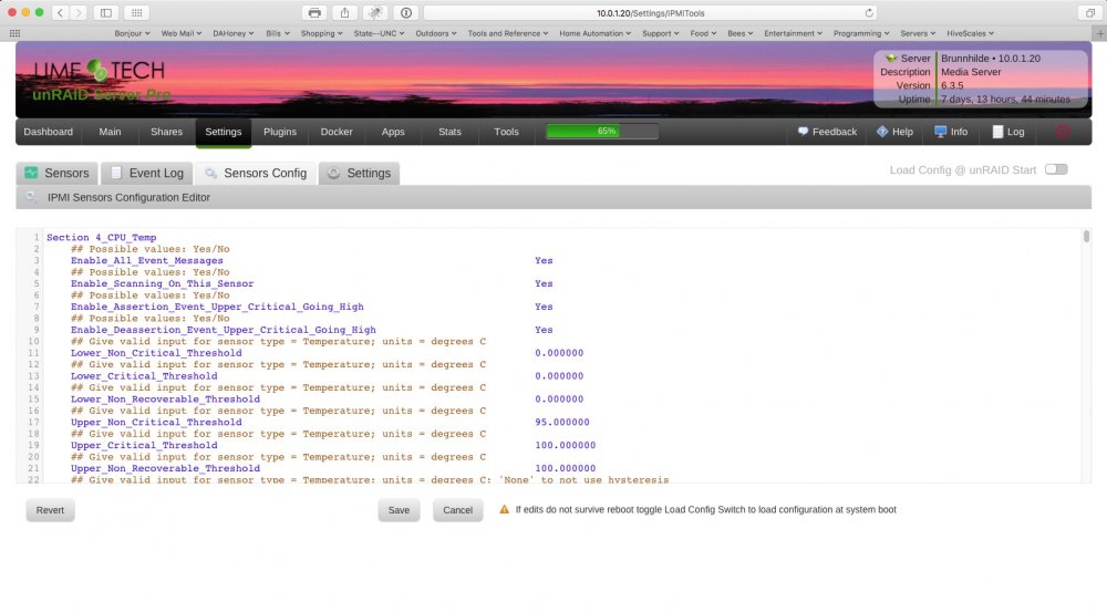

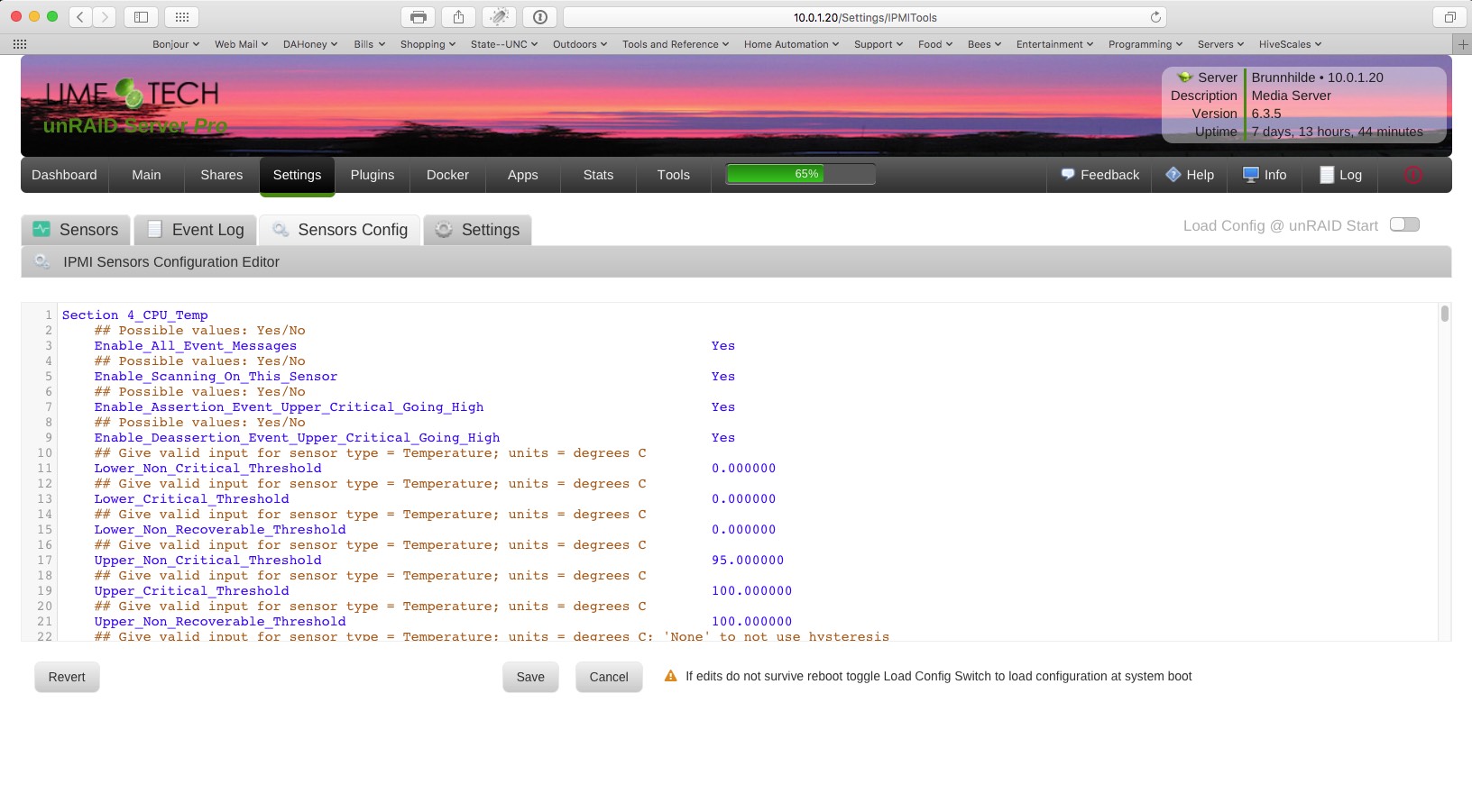

This will open a configuration text file that you can edit-
Just scroll down to the appropriate fan section, edit the threshold settings and save.
Thanks for the screenshot wgstarks.
Sent from my LG-D855 using Tapatalk
Hope that helps. You will see a section for each fan in the config file. I would recommend noting the original settings just in case you need to change them back.
So I need to put in values lower than those in thresholds to prevent it from shooting up once it hits the existing lower threshold right?
I believe just the "Lower Non-Critical". See if that helps after you save the settings.
