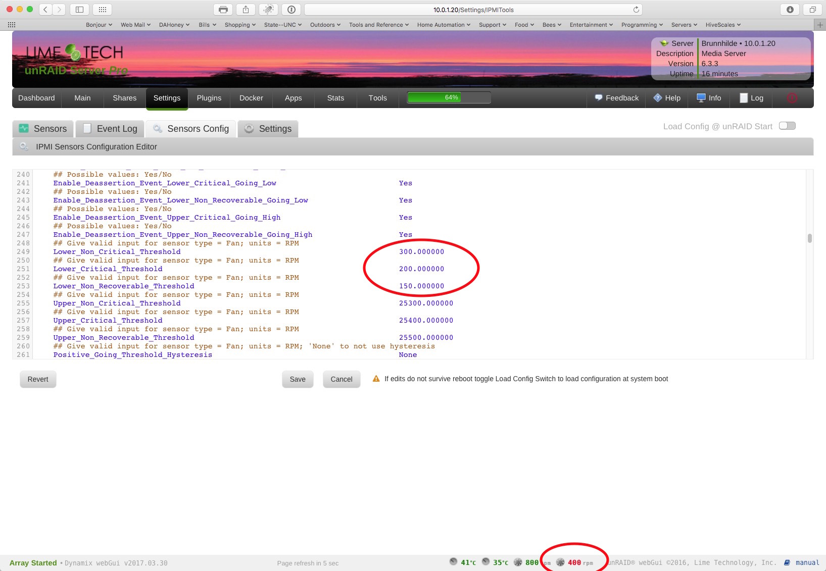

I recently updated the BMC firmware on my SuperMicro X10SLL-F to REDFISH_X10_352. Now any changes that I make to sensor configuration seem to be ignored. It looks like all fan speed thresholds have been reset to defaults and changes I make in the config file are not being applied. Anybody have any ideas how to fix this?
I would try clicking the revert command to pull a new config from your IPMI but if you loaded on startup then this might not work. Try renaming the ipmi-sensors.config or ipmi.config (whichever one is relevant) and rebooting. Then make changes to a fresh config.
My thinking is that something has changed in the config options with the bmc update and your writing config values that aren't valid anymore. Maybe the sensor or variable names have changed.
Where are these files located?
12 hours ago, dmacias said:
On the flash in /config/plugins/ipmi
Thanks. That worked. IPMI for the board is showing the correct thresholds.
Curious though about the footer display. I know Fan4 is bad. Waiting for a new set right now. That's why I have the threshold is set so low, just so I don't get flooded with notifications. Why does the fan speed show in red though in the footer when the speed is above the threshold? Did I miss another setting?
That's a bug. I found the same error the other day on a temp sensor. I'll include the fix on the next update.

I think there's just something going over my head. I pulled new configs down from BMC and I changed the thresholds back down to a proper range, but it doesn't seem to actually be affecting my fan speeds at all. I have a Supermicro X11SSM-F. Actually connecting to the server VIA IPMI and trying to change the settings there doesn't do anything either.
Edited by cyriouslydylan
Changing the thresholds is basically changing alarm/notification setpoints. Won't change fan speed.
