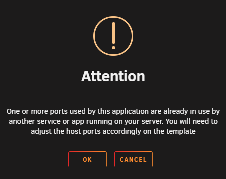

Today's update brings forth 2 things.
  1. Stopping a forth-coming long-awaited and major plugin (Soon TM) from appearing on spotlight apps on incompatible systems
  2. A warning / reminder to adjust host ports when installing a plugin that has conflicting ports to a service / app already running on your system
You may see something like this:
This app wants to use certain ports that are already allocated by either a native Unraid OS service or another app running on the server, and is simply a "reminder" to look at and change the host ports on this app so that they don't conflict.  Currently this should work against ~90% of the apps, and the remainder 10% either are not affected (run as host and can't be checked) or are v1 templates only which requires an overhaul to the appfeed to accomplish this. (soonish)
With luck this will lessen the support load on the very talented template authors / maintainers that contribute their various apps.
Any false positives etc please let me know.
Does this ignore dockers that have their own IP set ?
Otherwise great job bringing in this feature :)
4 hours ago, tjb_altf4 said:
old unused share configs that need deleting
It's only against running services and containers.  EG: If you disable SSH in the OS (port 443) there won't be a warning if another container wants to use 443.  If you have an app that's not currently running and you install another app that would conflict, there is no warning because there is no current conflict.
Yes.  Only templates that are set to bridge

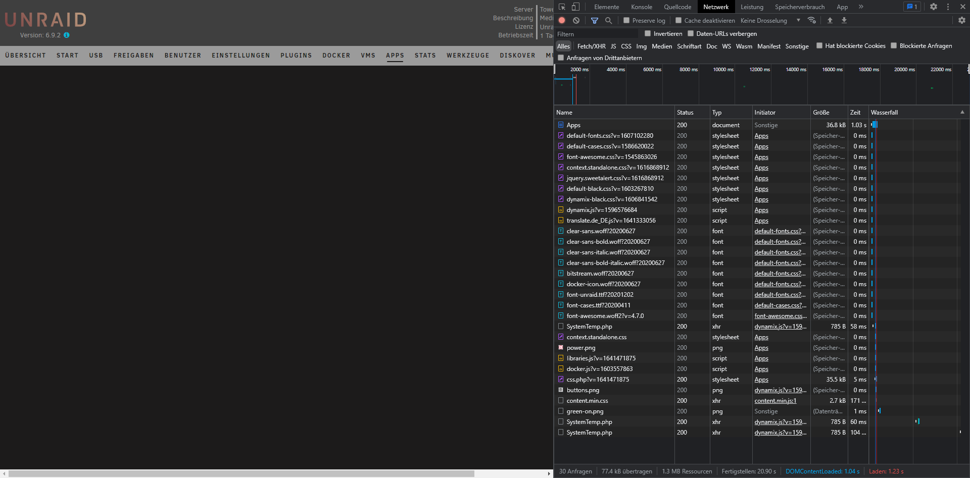

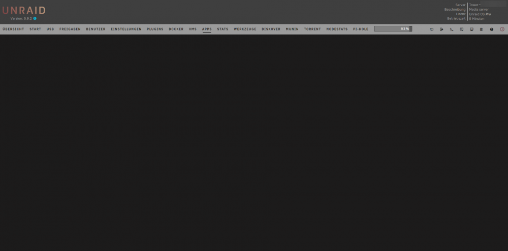

Since last days the Apps Button load a empy site.
Reinstall & Server Restart doesnt work
If i install this older CA from this
 the app Site works well. But after update to 2022.01.02a is empty again.
I did test it with FF & Chrome with ignotigo mode too.
I try to make a CA Debug log, but no log is shown to me.
Hm... Help? :D
Does the "spinner" in the browser tab keep spinning? (IE: the page never finishes loading)
No its not spinning after load the blank page in 1sec.
Edited by Wetterchen

I test [code]
wget -O /tmp/community.applications-2022.01.06-x86_64-1.txz https://github.com/Squidly271/community.applications/raw/master/archive/community.applications-2022.01.06-x86_64-1.txz installpkg /tmp/community.applications-2022.01.06-x86_64-1.txz
[/code] but nope its still blank page.
Only a older Version of CA is working.
Settings - Community Applications - Enable Debugging
Go To Apps, Wait a bit then Settings - Community Applications, Download Logs
If it's empty, then try the browser without any addons or I'd have to TeamViewer into your system.
Maybe does that help you?
I try to make a CA Log but i cant find any ca log in Logs Folder.
so we can try a Teamviewer Session.
If anything, I'd need to see what's showing in Konsole
Cant do the second part, there is no "Download logs" option for me.grafik.thumb.png.93d4be49bccc4224ab0ab8a044f97a70.pnggrafik.thumb.png.6e9e1cfc1569e263e151025656d51086.png
