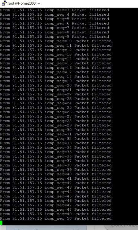

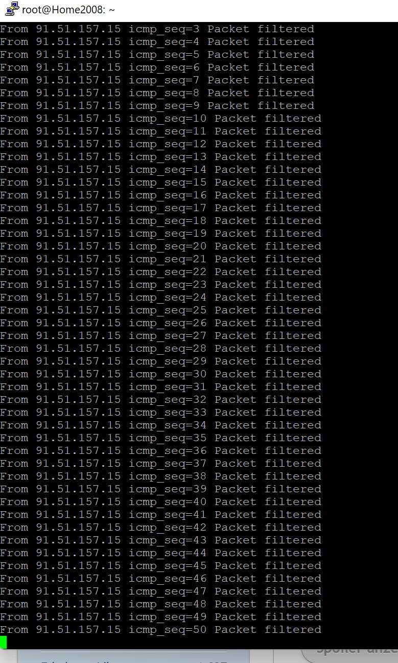

Yes I can Ping goolge. But the request never ends, runs endlessly.
That doesn't look like it's getting through.  Should be more akin to

This appears to be your router (or firewall) doing something.  If you don't get anywhere, create a new thread in General Support as this isn't strictly CA related
What I don't understand: Unraid ran without problems until 2 days ago, and now this. I can't install any APPS as a result. But I can't remove them either. Would it be better to reinstall Unraid and set it up again?Yes I can Ping goolge. But the request never ends, runs endlessly.
CTRL-C
The results that you posted show it's being "filtered"
Packet filtered is an ICMP response that indicates that the ping request was actively responded to with something other than icmp reply. Most likely cause is that the router, or some other router en-route rejected the request with icmp prohibited.
Your other option is to set static DNS addresses within Settings - Network Settings instead of the router.
I'm going crazy. My router had suddenly blocked the server from the internet via parental control. I took the parental lock off and it's working again.

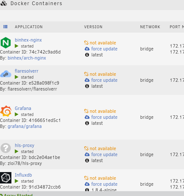

After downgrade CA to 2021.08.31 (to work with Unraid 6.8.3) all containers loose ability to autoupdate - link "not available". How to fix that?
Force update works well.
Edited by Nuke
Nothing to do with CA at all.  I'd force update everything then see how it continues.  Not Available means that the system couldn't determine if an update was available or not
Take a look here, worked for me

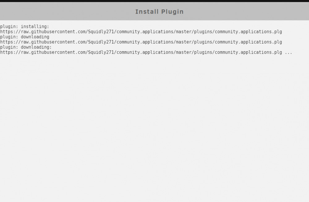

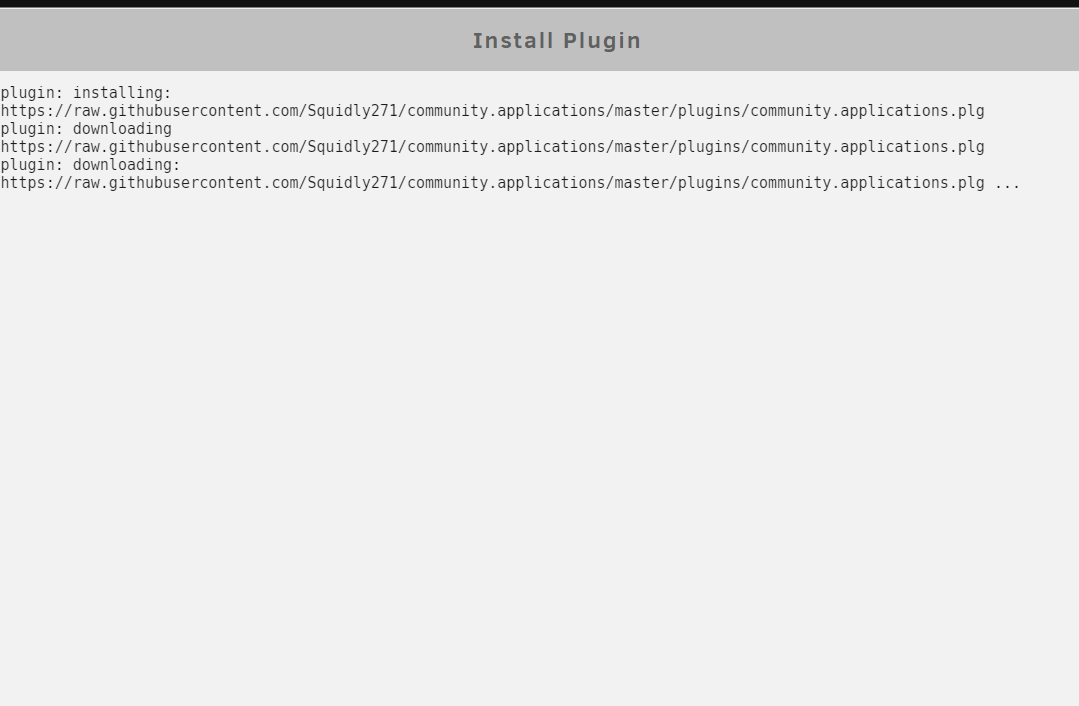

Hello everyone. I started updating the CA and got this result. Including Missing the "Apps" tab from the menu
I removed the plugin from the system, I'm trying to install it again, and the process freezes with this log.
Please, help. Thanks!
