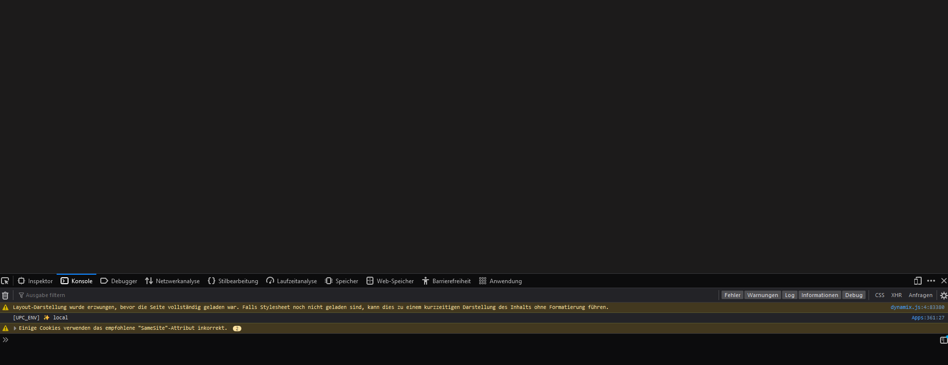

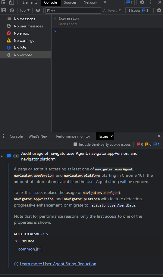

I had the same issue after upgrading CA, a blank page is displayed.
Did some investigation and the problem is a missing function "plain()" in helpers.php.
@Squidfollowing code correction makes it work:
# Get the ports in use #
function plain($ip) {
  return str_replace(['[',']'],'',$ip);
function getPortsInUse() {
Thanks @bonienl  I knew it was something related to the ports section.  Curious though that it worked on vast majority of systems due to how the network was configured.
Yes, it is was dependent on network and management configuration.
My test server worked fine, but my main server exhibited the issue.
Your latest CA update solves the issue.
Thanks, the new version fix the blank page!

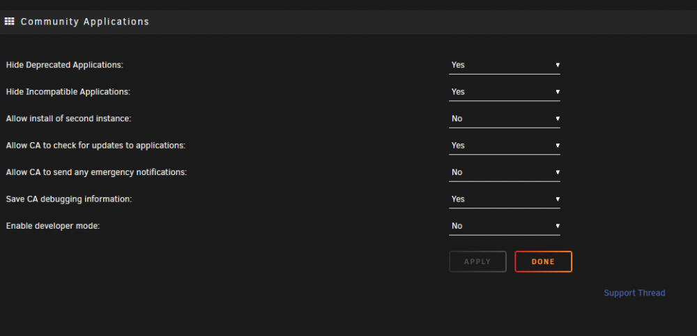

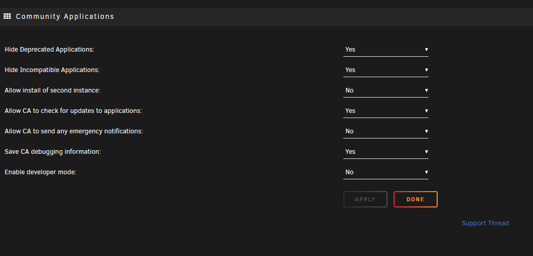

Did the settings change, I no longer see under settings for adding dockerhub. Any advice on getting it added back to my Unraid server?
